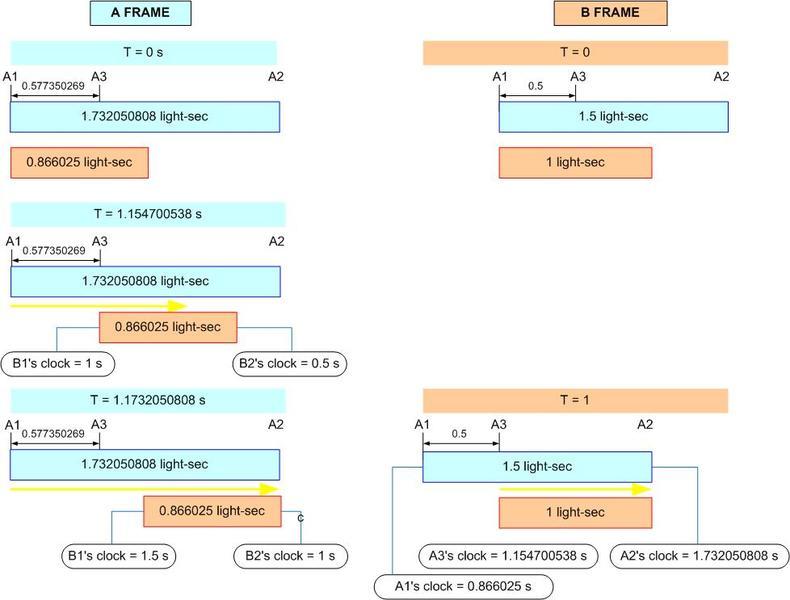

I have now reworked my numbers, with the aid of your explanations. I was trying to build an example where a synchronisation operation is carried out and then make the observers calculate relative velocity on the basis of the data obtained through such operation.
This is a better construction of the thought experiment:
STEP 1: A1 and B1 are traveling in long spaceships of unknown length. When they pass by each other, they set their respective clocks to zero. They are standing on the left ends of their ships and their respective assistants (A2 and B2) are standing on the right edges. It just happens that ship A is much longer.
At the time of the meeting, A1 sends a light signal to A2 and B1 sends another one towards B2, precisely in order to synchronise their respective clocks with those of their respective assistants.

STEP 3: B1’s light signal reflects back from B2 and hits B1. She looks at her clock and it marks 2 seconds.
So, in application of Einstein’s convention, she establishes that, at the time of STEP 2, the clock of B2 should have been set to 1/2 of 2 seconds, i.e., 1 second. In other words, the length of car B is 1 light second in B’s frame.
Now we imagine that A ship is crowded with an array of observers who have been constantly watching B1. A1 makes a survey among them with the aim of learning who observed that, when B1 passed by his side, B1’s clock was marking what it should mark at the time of STEP 2, that is to say, 1 second. This guy (A3) happens to be the one who occupies the mid-point of car A, as shown in this reproduction of STEP 2:
A1 ----------------------------A3 --------------------- flash >A2
.........>B1 --------------------- flash >B2
This is the clue for A to find out that B is traveling at 0.5 c. Logically, if the light signal has reached A2 at the time of STEP 2 and at such time B1 had traversed half the light path, A must infer that B travels, relative to him, at half c.
Now we should check whether this result is confirmed by transforming B’s figures into frame A’s on the basis of relativistic formulae that use v = 0.5 c.
As to time: B1 has attributed to B2 a time of 1 second for the moment when event STEP 2 took place. In application of the Lorentz Transformation, this must be converted for A2 into (1+0.5)/(0.866025404) = 1.732050808 seconds. In principle, this is the time for A2 when the light signal reached the latter. But time is synchronous for A throughout his own frame, so A3 should be reading the same time when such event STEP 2 took place. And STEP 2 means two things: light reached A2 and B2, but also A3 and B1 coincided in space and time.
As to length: Based on what is said above, the length of car A is 1.732050808 light seconds in A’s frame. Thus A3 would conclude that, when B1 was passing by, it had traversed half the length of car A (which is 0.866025404 light seconds) in precisely 1.732050808 seconds. This gives back a speed for B of 0.5 c.
We can reach the same conclusion by transforming B's measurement of length. B claims that her car B is 1 light second long, but (as measured in A’s frame) B suffers length contraction: for A, that car is only 0.866025404 light seconds long. So the distance that B1 has traversed is 1.732050808 light seconds minus the length of car B, which (as noted) is for A 0.866025404 light seconds. This difference is also 0.866025404 light seconds. Therefore, we confirm again that B1’s velocity is 0.866025404 light seconds/1.732050808 seconds = 0.5 c.
And now let us take the perspective of B’s frame: A claims that his car is 1.732050808 light seconds long, but as measured in B’s frame A suffers length contraction: for B, that car is only 1.5 light seconds long. Hence the distance that A1 has traversed to the left is equal to the length of car A as measured by B (1.5 light seconds) minus the length of car B also as per B’s standard (1 light second). This difference is 0.5 light seconds. Conclusion: A1 has traversed 0.5 light seconds at the time of STEP 2 (1 second) and therefore A’s velocity is 0.5 light seconds/1 second = 0.5 c.
Thus it is confirmed, as you pointed out, that both parties get the same relative velocity for each other. But a funny situation arises. The distance A1-B1 in the above picture will be:

JesseM said:
But if B1 read 1 second, this will be simultaneous with the event of B2 receiving the flash in the B frame, but not in the A frame; if the clocks at B1 and B2 are synchronized in the B frame, then in the the A frame the clock at B1 is actually ahead of the clock at B2 by some constant amount. So B2 won't read 1 second until some time after B1 read 1 second in the A frame, and if B1 reads 1 second when it passed A3, and B2 reads 1 second at the time the flash reaches it and it's next to A2, that means in the A frame B2 has yet to reach A2 at the moment that B1 is passing A3. Your diagram above only shows what's happening in the B frame, not the A frame.
OK. This means that, what is one single STEP 2 (containing two simultaneous events) for B, is a sequence of two events in A's frame:
- 2.1, when B1 meets A3 and B1's clock reads 1 s, while B2 has not yet reached A2, has not been yet reached by the light signal and B2's clock reads 1 s minus something.
- 2.2, when B2 (whose clock does read "now" 1 s) meets A2 and they are both hit by their light signals, while B1 has already left A3 behind and B1's clock reads 1s plus something.
But then you say...
JesseM said:
If the diagram above represents the B frame, then that must mean that in the B frame, the distance from A3 to A2 is 1 light-second, and since A3 was the midpoint that means that in the B frame the distance from A1 to A2 is 2 light-seconds. But the distance from A1 to A2 must be longer than this in the A frame (since it's Lorentz-contracted in the B frame), it must be 2/sqrt(1 - v^2/c^2), whatever the value of v in this problem.
It is clear that, following your correction, the diagram only represents B frame, where the distance from A3 to A2 is 1 light-second. But then you deduce that "since A3 was the midpoint" (of A's car) "that means that in the B frame the distance from A1 to A2 is 2 light-seconds". Then on the basis of that assumption you conclude that the length of A car is longer in A frame, being equal to 2/sqrt(1-v^2/c^2). However, I have a doubt about the assumption. A3 is the midpoint of car A in A's frame. But in B's frame car A is, as it is usually said, "foreshortened in the direction of motion": since, as viewed by B, A is moving to the left, car A is to be shortened by its left side. So could I not hold that in B's frame A3 is not the midpoint of car A, but is shifted to some extent to the left, as if the car had been squeezed like a spring from the left side? Or, on the contrary, does the Lorentz contraction act proportionally on all parts of the body in question?

Saw said:
Does this mean that I should give up with my search for meaningful numbers for the example of which you said, at the beginning, that it made sense, so far?
No, it just means you'd need to change the assumption that A3 was at the midpoint between A1 and A2. Suppose instead that A3 was 1/3 of the way from A1 to A2, which means in the B frame A is 1.5 light-seconds long, so it must be 1.5/sqrt(1 - v^2/c^2) long in the A frame. Then the distance from B1 to B2 is still 1*sqrt(1 - v^2/c^2) in the A frame, so if B1 is at position x=0 at t=0 when the light is emitted from B1 (with A1 also at x=0), then the position of B2 as a function of time is still x(t) = vt + sqrt(1 - v^2/c^2). So again we find that in the A frame the light will catch up to B2 when t satisfies the following equation:
vt + sqrt(1 - v^2/c^2) = ct
And as before, when the light catches up with B2, B2 is at the same position as A2, which is now at position x = 1.5/sqrt(1 - v^2/c^2). Since the light's position as a function of time is x(t) = ct, we know it will reach A2 (and B2) at the value of t such that ct = 1.5/sqrt(1 - v^2/c^2), or t = 1.5/c*sqrt(1 - v^2/c^2). So we can substitute this value of t into the previous equation:
[1.5*v/c*sqrt(1 - v^2/c^2)] + sqrt(1 - v^2/c^2) = 1.5/sqrt(1 - v^2/c^2)
Now we can multiply both sides by sqrt(1 - v^2/c^2) which gives:
1.5*v/c + 1 - v^2/c^2 = 1.5
Subtract 1.5 from both sides, then multiply both sides by -c^2 to get:
v^2 - 1.5*vc + 0.5*c^2 = 0
You could use the quadratic formula here, but I'll take a shortcut and note that if you add 0.0625*c^2 to both sides you get:
v^2 - 1.5vc + 0.5625c^2 = 0.0625c^2
and the left side simplifies to:
(v - 0.75c)^2 = 0.0625c^2
So, take the square root of both sides, which gives two possible solutions:
v - 0.75c = +0.25c or -0.25c
If we use v - 0.75c = +0.25c, that again leaves us with v=c which we don't want. But if we use the second solution, v - 0.75c = -0.25c, that gives v = 0.5c.
Just to check that works, note that in the A frame, A is 1.5/0.866025404 = 1.732050808 light-seconds long, and B is 1*0.866025404 light-seconds long. So, since x(t) for B2 is given by x(t) = 0.5*t + 0.866025404 (because it's moving at 0.5c and it started at x=0.866025404 light-seconds), we want the value of t such that 0.5*t + 0.866025404 = 1.732050808 (when B2 has reached A2 at x=1.732050808 light-seconds), which means t = 1.732050808. And of course, if x(t) for the light is given by x(t) = 1*t, then of course at t = 1.732050808 seconds the light is also at position x = 1.732050808 light-seconds.
I am afraid of boring you. This is what I have understood (hope it is self-explanatory):

Coming back to the point (how to calculate RV), I see that the system of home-made measurements works, but I have questions as to the combination of measurements.
I know that only the first is practical. The second leads to a vicious circle, because you cannot combine the foreign measurement with your own without first transforming the former and you cannot transform without knowing v. But once v is known, the method should work…
Let us take the example of the displacements of:
- In frame A: B1 as it travels from A1 to (A1-A2)/2.
- In frame B. A3 as it travels from (B1-B2)/2 to B1.
As to home-made measurements, it is clear:
- In frame A: B1 travels 0.866025404 light-seconds in 1.732050808 s, so v = 0.5c.
- In frame B: A3 travels 0.5 light seconds in 1 s, so v= 0.5 c.
As to combined measurements:
In frame A [B1 travels from A1 to (A1-A2)/2]:
(a) My length – your time:
- My length: B1 has traveled in A frame 0.866025404 light-seconds.
- Your time: The observer in the midpoint of A1-A2 looks at B1’s watch and reads 1.5 s. He realizes that this is time dilatated (too few long seconds) and enlarges it by 1/sqrt(1-v^2/c^2) into 1.732050808 s.
- The division is 0.5 c, which is OK.
(b) My time – your length:
- Your length: B1 is asked which distance the observer at the midpoint of A has traveled in her B frame. Her answer is 0.75 light-seconds. If the A observer then assumes that this distance is length contracted (too many short light-seconds) and shrinks it by sqrt(1-v^2/c^2), he will get 0.64951905 light-seconds.
- My time: B1 has traveled in A frame during 1.732050808 s.
- The division is 0.375 c, which is not OK.
My try at an explanation: B1’s “length” measurement in reality hides a time measurement. She has done one of these two things:
• She has recorded with her clock how much time it has elapsed between the passage of A1 and the arrival of (A1-A2)/2. This time interval is 1.5 s. (This would be a new picture not shown in the diagram). Then she has multiplied it by 0.5 and obtained 0.75 light-seconds. But her measurement of time is dilatated and converts for A into 1.732050808 s, which multiplied by 0.5 gives 0.866025404 light-seconds.
• An assistant of hers, with whom she has synchronized clocks, annotates the time when (A1-A2)/2 passes by and she does the same. The difference is again 1.5 s, which multiplied by 0.5 gives 0.75 s. But this time difference is time dilatated…
In frame B [A3 travels from (B1-B2)/2 to B1]:
- My length: A3 has traveled in B 0.5 light-seconds.
- Your time: For A3 the travel time is 1.154700538 s. If B thought that this is time dilatated, she would enlarge it and convert it into 1.333… But this would not work. Instead, she accepts that it is her own B clock that slows down and shrinks it to 1s, which is what her clock actually reads.
- Your length: If asked, A3 would say it is 0.577350269 light-seconds. If B thinks that this distance is length contracted and shrinks it by sqrt(1-v^2/c^2), she will obtain 0.5 light-seconds.
- My time: 1s.
- Division is 0.5 c.
Questions:
Are the numbers right by chance? (I am totally dizzy now and I agree with Atyy that his exercise was masochist… In fact, in a previous calculation which got deleted, there was also a problem with foreign measurement in frame B...).
It seems as if there is lack of reciprocity.
Would the concept of “proper” measurement play a role here?
Yes. Note, though, that this only works because at t=0 in the A frame, the B1 clock also read t'=0, which ensures that at t=T in the A frame the B1 clock will always read t'=T*sqrt(1 - v^2/c^2). If you had tried something similar with B2 without taking into account simultaneity issues it wouldn't have worked.
But that would be the wrong procedure for figuring out how far B1 traveled between when it was lined up with A1 and when it was lined up with the midpoint of A (call this midpoint Am for short), in the frame of A. After all, suppose you have a third rod at rest relative to B and 0.75 light-seconds long in B's frame, placed so that the right end lines up with Am at t'=0 in B's frame (at the same time B1 is lined up with A1 in this frame), and the left end lines up with Am at the moment it reaches the same position as B1 (and since this rod is at rest relative to B, that means the left end is always lined up with B1). The two ends of this rod show the distance Am travels between the moment A1 is lined up with B1 and the moment Am is lined up with B1.
Now if we switch to A's frame, it's true that this third rod is shrunk by sqrt(1 - v^2/c^2), so its length is 0.64951905 l.s. However, in this frame it is not true that this rod has its right end lined up with Am at the moment that B1 is lined up with A1, because of simultaneity issues (in B's frame the event of B1 and A1 lining up was simultaneous with the event of the right end of the third rod lining up with Am, so these events must be non-simultaneous in A's frame). Therefore you can't use the length of this rod to judge the distance Am traveled between the moment A1 lined up with B1 and the moment Am lined up with B1.
OK, that works.
With observers at different positions you also have to take into account that if their clocks are synchronized in B's frame, they are out-of-sync in A's frame--in this case, in A's frame the clock at B1 will be ahead of the clock at the assistant's position (which is 0.75 l.s. away from B1 in the B frame) by (0.75 l.s.)*(0.5c)/c^2 = 0.375 seconds. So at t=0 in the A frame, B1's clock reads t'=0 s, and the clock of the assistant reads t'=-0.375 s. If B1 is at x=0 in the A frame at this moment, then the assistant is at x = (0.75 l.s.)*(sqrt(1 - 0.5^2)) = 0.64951905 l.s. at this moment in the A frame, and the midpoint of A must be at x=0.8660254 l.s. at this moment in the A frame since this is half the rest length of A. So the distance from the midpoint to the assistant at t=0 in the A frame is 0.216506 l.s., meaning the midpoint will line up with the assistant at t = 0.216506/0.5 = 0.43301 seconds in the A frame. The assistant's clock will have elapsed 0.43301*0.8660254 = 0.375 seconds in this time, and since it started off reading -0.375 s at t=0 in this frame, it will read exactly 0 when the midpoint passes it.
Also, at t=0 the midpoint was at a distance of 0.8660254 from B1 in this frame, and B1's clock read 0 at that moment. So, the midpoint will catch up with B1 at t = 0.8660254/0.5 = 1.732051 seconds, and since B1's clock was running slow by a factor of 0.8660254, B1's clock will read 1.732051*0.8660254 = 1.5 seconds at the moment the midpoint catches up with it.
No, there's no need for B to conclude her own clock slows down. Again, she can explain these numbers using the relativity of simultaneity--in the A frame the clocks at A1 and A3 are synchronized and a distance of 0.577350269 l.s. apart, so in the B frame the clock at A3 must be ahead of the clock at A1 by a time of (0.577350269 l.s.)*(0.5c)/c^2 = 0.28867513 seconds. So at t'=0 in the B frame, the clock at A1 reads 0 seconds, and the clock at A3 reads 0.28867513 seconds. This means that if A3 reads 1.154700538 seconds when it passes B1, it has elapsed a time of 1.154700538 - 0.28867513 = 0.866025 seconds. And if B assumes that A3 was running slower than her clock (not the other way around) by a factor of 0.866025, she will conclude that in her frame 0.866025/0.866025 = 1 second has passed between the moment A1 passed her and the moment A3 passed her. So if A3 traveled 0.5 light-seconds in this time, it must have moved at 0.5c.
Yes, B will say the distance from A1 to A3 is 0.5 light-seconds.
Saw said:
- My time: 1s.
That's right.
Saw said:
Questions:
If you take into account the relativity of simultaneity along with time dilation and length contraction, you do have reciprocity--each observer says that points on the other rod which are a distance L apart in the other rod's rest frame are a distance of L*sqrt(1 - v^2/c^2) apart in the observer's own frame, each observer says that any individual clock moving along with the other rod is slowed down by a factor of sqrt(1 - v^2/c^2) in the observer's own frame, and each observer says that if there are two clocks attached to points on the other rod which are a distance L apart in the rod's rest frame, and the two clocks are synchronized in the rod's rest frame, then in the observer's own frame the trailing clock will be ahead of the leading clock by vL/c^2.
Thanks. Yes, I had complicated myself by considering too many situations (in fact, it suffices to analyse just one from different viewpoints) and with a bad approach to the issue of combined measurements.
Just in case anyone is interested, I post here a “clean” version of how my question gets answered:
Velocity is distance divided by a time interval. Any measurement of velocity is the “story” of two events: two points of one frame (L1 and L2) meet successively with one single point of another frame. The length is the difference L2 – L1. As to time, it may happen that:
* At L1 and L2 there are synchronised clocks C1 and C2, which register the time (T1 and T2) when the single point of the other frame passes by each of them. The time interval is the difference between the two readings = T2 – T1. Thus in this case the measurement is constructed with the instruments of one single frame. We could all it a purely “local or home-made measurement”.
* Time is registered, instead, by a single observer, who annotates the readings of his single clock when it meets L1 and L2 (T1 and T2). Time is again the difference between the two readings = T2 – T1. Eventually, the two frames may swap roles: the single observer gets a space reference in his frame to measure distance; one of the two observers steps out and the remaining one measures time. As this method mixes measurements from two different frames, we can call it a “combined measurement”.
In classical relativity, due to the homogeneity of time and length intervals, as well as of simultaneity, everything is easier.
For example, these two stories:
- in A frame, the transit of B1 from A1 to A3 and
- in B frame, the transit of A3 from Bm to B1
are identical, because the length A1-A3 = the length B1-Bm, the transit time for B1 to go from A1 to A3 = the transit time for A3 from Bm to B1 and the two stories start and end at the same time.
That is why it is expected that local measurements will give the same result not only in terms of speed: also the denominator (length) and the numerator (time interval) will be identical. Likewise, in combined measurements, each frame can rely on the other frame’s measurement as if it were his or her own.
In SR, things are more complicated. Both frames do obtain in the end the same speed for each other, but the “stories” of the measurements are different.
The story may be in B frame, for example, like in the picture of classical relativity = A3 meets Bm (at the same time as A1 and B1 meet) and later A3 meets Bm. Thus B frame would make these “local measurements”:
When A3 passes by Bm, the latter annotates the time (TB1) = 0 s.
When A3 passes by B1, the latter annotates the time (TB2) = 1 s.
The difference = dTB = TB2 – TB1 = 1 s.
The distance between B1 and Bm in B frame is 0.5 l.s.
Hence v = division of B length by B time = 0.5 l.s. / 1 s = 0.5 c.
However, this is STORY B. But A would measure a different story. If the pairs A1-B1 and A3-Bm are aligned simultaneously in B frame, they are forcefully not in A frame. In A frame, the rod B1-Bm is shorter and so, at TB1 = 0 s, Bm is not yet lined up with A3 and this will only happen a little later, after Bm traverses a little additional path.
Thus if A frame wants to make his local measurement of velocity, he has to choose between two stories:
STORY A: B1 travels from A1 to A3.
STORY A bis: B1 travels to A3, although not from A1, but from the place that B3 occupies when (as per A’s line of simultaneity) Bm reaches A3 = B1 travels from A.1.1 to A3.
Nevertheless, both STORY A and STORY A bis lead to the same measurement of relative velocity:
In STORY A, A frame measures that B1 travels a longer length in longer time:
The distance between A1 and A3 in A frame (LA) is 0.577350269 l.s.
When B1 passes by A1, the latter annotates the time (TA1) = 0 s.
When B1 passes by A3, the latter annotates the time (TA2) = 1.154700538 s.
The difference = dTA = TA2 – TA1 = 1.154700538 s.
Hence v = division of LA by dTA = 0.5 c.
In STORY A bis, A frame measures that B1 travels a shorter length in shorter time:
The distance between A1.1 and A3 in A frame (LA bis) is 0.43301270 l.s., which is the same as the distance B1-Bm in A frame = half the length of B car in A frame.
When B1 passes by A1.1, the latter annotates the time (TA1bis), which can be guessed as follows: The distance that B1 must traverse in A frame so that Bm lines up with A3 is equal to the difference between A1-A3 (0.55577350269 l.s.) and B1-Bm as measured in A frame (0.43301270 l.s.), which is 0.14433757 l.s. Travelling at 0.5 c, B1 will need 0.28867513 s to traverse such distance. Besides, we can also obtain the same result reasoning with the sync factor: B1 will judge that, when she meets A1 and Bm meets A3, A3 (which is moving away) will be ahead by the factor LAv/c^2, LA being the distance that separates A1 and A3 in A frame (0.55577350269 l.s.) = 0.28867513 s. So TA1 bis = 0.28867513 s.
When B1 passes by A3, the latter annotates the time (TA2bis) = 1.154700538 s.
The difference = dTA bis = TA2 bis – TA1 bis = 0.866025 s.
Hence v = division of LA bis by dTA bis = 0.5 c.
If we put together all these numbers, we would realize that A measures, depending on the A story we choose, either more length and more time than B or less length and less time than B, but the two things always go together (if you increase time, you increase length as well; if you reduce length, you reduce time) and the proportion for either increasing or reducing B numbers is always the same [(sqrt(1-v^2/c^2)]. Otherwise it would be impossible that both frames measured the same relative velocity…
If we now consider “combined measurements”, we find that the two frames also measure the same relative velocity.
Let us analyse, first, the hypothesis where the two ends of the rod B1-Bm pass by A3:
- Length is measured in B frame as the length B1-Bm = LB = 0.5 l.s.
- Time is measured by A3’s clock:
TA1 = the reading of A3’s clock when he meets Bm, as noted above, is = 0.28867513 s.
TA2 = the reading of A3’s clock when he meets B1, as noted above is = 1.15470053 s
dTA = 0.86602540 s.
- If B wants to combine her length LB with A3’s dTA, she must assume the latter is too short and enlarge it through multiplication by 1/sqrt(1-v^2/c^2) = 1 s. Thus division of 0.5 l.s. by 1 s = 0.5 c.
- If A3 wants to combine his time dTA with LB, he must assume the latter is too long and shrink it trough multiplication by sqrt(1-v^2/c^2) = 0.43301270 l.s. Thus division of 0.43301270 l.s. by 0.86602540 s is again 0.5 c.
Now the case where the two ends of the rod A1-A3 pass by B1:
- Length is measured in A frame as the length of the rod A1-A3 = LA = 0.577350269 l.s.
- Time is measured by B1’s clock:
TB1 = the reading of B1’s clock when A1 arrives, as noted above, is = 0 s
TB2 = the reading of B1’s clock when A3 arrives, as noted above, is = 1 s
dTB = 1 s
- If A wants to combine her length LA with dTB, she must assume the latter is too short and enlarge it through multiplication by 1/sqrt(1-v^2/c^2) = 1.15470053 s. Thus division of 0.577350269 l.s. by 1.15470053 s = 0.5 c.
- If B1 wants to combine his time dTB with LA, he must assume the latter is too long and shrink it trough multiplication by sqrt(1-v^2/c^2) = 0.5 l.s. Thus division of 0.5 l.s. by 1s is again 0.5 c.
Conclusion: it is true, thanks again. If you consider the three effects together (TD, LC and RS) there is reciprocity in each of them and, in spite of that, the two frames obtain the same relative velocity for each other, no matter whether they use local or combined measurements.
One question: I understand “speed” does not include direction, while “velocity” does. Given this, technically speaking, which term should I be using throughout this text? Since we talk about a common concept (each frame may deem itself to be stationary for measurement purposes, but they agree that in fact there is relative motion between them), I feel that direction plays no clear role here. But what exists, instead, is the difference between approach and recession, which sometimes are referred to conventionally as positive and negative velocity, respectively. So would “velocity”, in the end, be the right choice?
Finally, to close the circle, I just need to understand the frequency method… But that is for another day.
