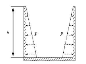

You haven't taken into account the fact that the pressure is gradually increasing with depth, from a value of zero at the surface to a value of ρgh at the bottom. Your equations assume that the pressure is constant at ρgh over the entire depth.

If you draw the pressure profile along one wall of the aquarium, you'll see that the hydrostatic pressure p = 0 at the surface and p = ρgh at a depth of h meters below the surface.
The hydrostatic pressure on the sides of the aqarium would look like so:
Does this give you a hint as to where the factor of 1/2 comes from, when evaluating the force due to hydrostatic pressure on one wall of the aquarium?

Ohhhh, so I was evaluating it at 2 walls essentially, since I was just doing the whole pressure going across one level?

I think in your original analysis, you overlooked some things.
For one wall of the aquarium, the hydrostatic force along one horizontal strip will be dF = P dA, where P = ρg h. For dA, since it is a horizontal strip, we can say dA = w * dh, where w is the width of the side and dh is a small height.
Plugging into dF = P dA,
dF = ρg h * w * dh = w * ρg * h dh
Integrating both sides of the equation above:
∫ dF = ∫ w * ρg * h dh
F = w * ρg ∫ h dh
F = w * ρg h2 / 2
which is basically saying that the hydrostatic force is equal to the volume of a triangular prism w units long × h units deep × ρgh units wide at the base.

Oh! It makes so much more sense now that I saw you split the dA into it's width and height components! Thank you!
