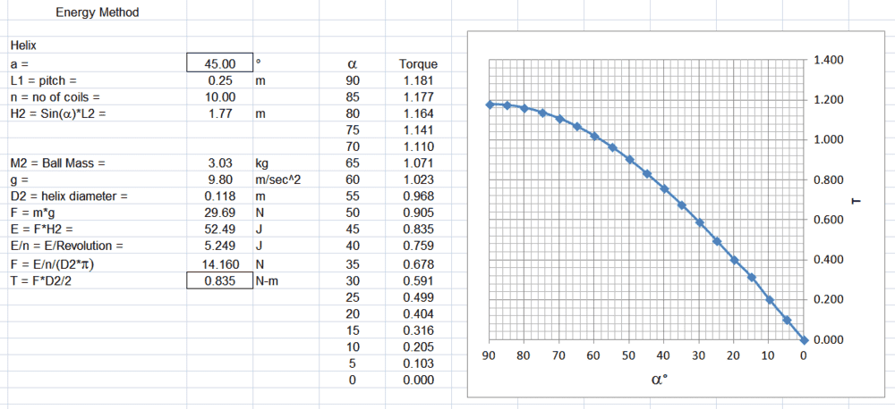

Well I have a new analysis (much better than my last effort) that seems to work but does not correlate with the Bernoulli or a modification of that equation as discussed above.
The sin(α + β) equation simply converts angle inputs in terms of "β" to be converted into an equivalent rotation of "α" about its horizontal perpendicular axis so that when β = α then α = 0.
Note: Without the requirement to use the "β" angle of the helix axis as an input, the torque values due to the helix pitch rotation can be calculated by simply entering increasing "α" values from 33.995 to 90 degrees.
A screenshot of my Excel worksheet calculation is below:

Well I have a new analysis (much better than my last effort) that seems to work but does not ……
The calculation result of your Excel sheet is similar to that of my Excel sheet, except that I don't understand how to calculate the torque of steel ball. If your calculation result is correct, it will be no problem to use this spiral tube to manufacture my machine.Your calculation result is within my experimental value, it may be correct.

@Baluncore, Good catch, I understand your point and you are correct. While first developing my calculation, whenever α rotated below α (34°) I was getting negative tangent force values, so I worked out a method to correct that issue.
However, while now looking at a diagram I drew today, it appears the issue is that while the pitch angle of the helix is 34°, when viewed from the side of the helix each the wrap appears as V with its perpendicular to the helix axis being 1/2 of the wrap pitch angle.
With that in mind, when α reaches 0° the side view of one wrap of the helix becomes a vertical V and the ball sits in the bottom of that V and no torque exists.
Looks like I have more work to do!

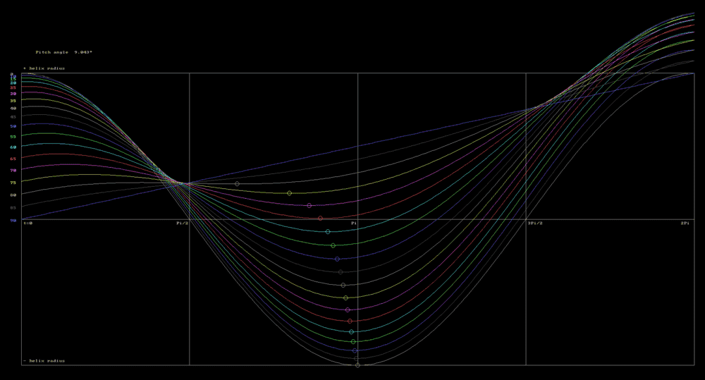

  • #84
Here is my minimum solution. The derivation of this is a little longer.
First Specify Helix and Ball Parameters.
d = 45 ' tilt of helix axis above horizonal in degrees
r = 0.059 ' radius of helix cylinder, metre
p = 0.250 ' pitch, helix advance per turn, metre
m = 3.030 ' mass of ball in kg
g = 9.8 ' acceleration due to gravity
' Precalculate
Pi = 4 * Atn( 1 ) ' a value for Pi = 3.14159
a = d * Pi / 180 ' convert tilt of helix in degrees to alpha in radians
' main computation
ka = Cos( a ) * r ' precompute two coefficients of the derivative to find minimum
kb = Sin( a ) * p / ( 2 * Pi )
t = Pi - Asin( kb / ka ) ' theta is the angular position of minimum on each helix turn
q = m * g * r * Sin( t ) * Cos( a ) ' torque on helix axis
' The result for the specified ball in a helical tube is;
Torque = 0.835437 Nm
' and if you need it;
b = Atn( p / ( 2 * Pi * r ) ) * 180 / Pi ' pitch angle in degrees
Pitch angle = 33.995 °

Finding the position of the minimum on the helix turn is necessary. I wrote the equation for the height of the helical filament, then took the derivative of that and solved it for zero. The position of the second zero is the minimum.
This graph shows height of first turn for different alpha. The position of the analytic minimum is marked with a small circle.

Then in post #88 I gave my full derivation of the method. So others may compare their results.
You do not need to understand the full derivation. Do the calculation in post #84.
