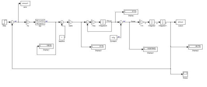

Hello, I'm not looking for an answer to my problem, just some hints. Any help would be greatly appreciated.
I am required to control a hexacopter, so I'm designing a lead compensator to control the height, it should be able to counteract the pull of gravity. So far I have designed it, but my problem is that I need its output to be in PWM form.
I already have a scaling which is a= 0.1956 N/PWM, it is also given that a value of 143 PWM will generate hover thrust.(These constants are found from tests on the motor, and are for all 6 motors).
I realize that the feedfwd (see block diagram) should be some value, but I don't know what.
Attached is a snapshot of the block diagram.
Thanks for any help :)
