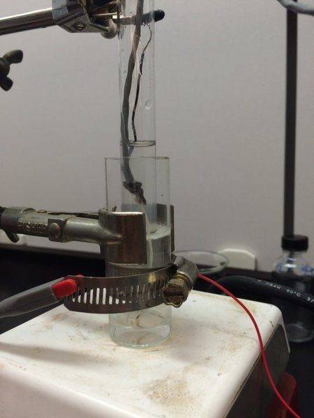

The current test setup is as pictured:
I am judging whether or not this succeeds by the presence or absence of a swirl recoil: https://en.wikipedia.org/wiki/Recoil_(fluid_behavior). If there is successful separation of counterions from the surfactants then the solution should not recoil.
My power supply goes to 50 VDC. I confirmed there was no current flow at 50 VDC. 50 VDC had no effect on the solution. Like you said, higher voltage requires more care.
This bench scale experiment has about the same gap as what the full scale will be. Narrowing the gap is not a good option. The only thing I know of is higher voltage, but I am not sure how to do so safely and cheaply.
Also, would AC make any difference?
Thank you for your time so far. I am new to these forums and would appreciate any advice on how to get the most information out of them.
I forgot to mention that the solution in the inner tube is a saturated brine solution so that it is conductive.
AC power would reverse the direction of migration 50 or 60 times per second. I expect that would ruin the experiment.
Radio frequency RF signals may or may not do something different, but that is outside my expertise. I just think about how violently microwaves shake those water molecules.
