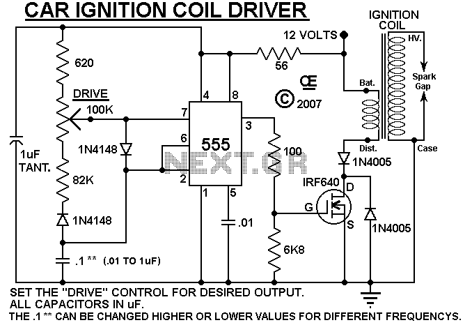

Can you tell us more what you are trying to do? What configuration of wires do you mean - are they parallel or pointing their ends to one another? What size of spark do you want?
The device creates an electrical discharge.
The wires are parallel and the electrical
Discharge lasts as long as I hold a button down. How do I build that?
This circuit works well.
244192

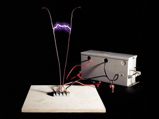

and also a Jacob's Ladder
Tho seeing @David lopez 's other threads
I'm not sure he is really skilled enough to be working with high voltages ?
