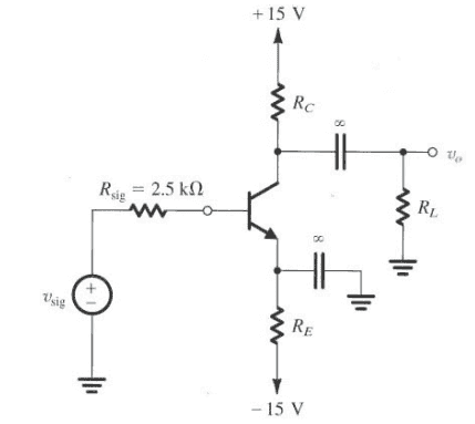

The circuit above shows a simple transistor amplifier with the given data:
β=100, VA = 100V, RL = 10kΩ
a) neglect the "early-effect" and design the circuit so that IE = 0.5mA and VC = 5V.
I'm familiar with the β part, it means DC gain, or collector current divided by base current. What I'm not familiar with is VA. Where is VA measured? If it's a typo, what can it be? I would ask my professor this, but he's away for the week so that makes it slightly difficult.
More to the problem itself. The DC analysis here should be very straight forward, I feel I just need some help to get started.
I need to set up an equation here so that IE = 0.5mA and VC = 5V. Do I also need to analyse the base-to-collector "junction" to see if it's a forward or reverse biased pn junction? That way I get the base-to-collector voltage (VBC)
Pardon me if I'm far off here, but I'm looking at a slightly different circuit for DC analysis.
Any help of guidance here will be greatly appreciated, thanks.

The circuit in your post #1 has capacitor coupling to RL so the DC current does not divide between RC and RL. You can ignore RL when designing biasing. In your design you need for Vsig to be both a source of DC (for biasing) and a small signal source (to illustrate AC amplification).
Yes, assume VBE = 0.7v.
I'm assuming IB = IC. If this is wrong, please try to explain why.
Surely you mean IC = β.IB?
Mutaja said:
II get this:
I'm assuming IE = IC. If this is wrong, please try to explain why.
Close enough. Accurate to within 1% since β=100. The right thing to do.
(Note that I changed your IB to IE. The BJT equations are IC ~ IE = βIB if the device is biased in the active region.)
Forget RL. This is a dc setup computation.
1. Compute VE. Assume VB = 0 (accurate to 10 mV). Assume VBE = 0.7V.
2. Compute RE to give 0.5 mA.
3. Compute RC to give VC = +5.0V.
