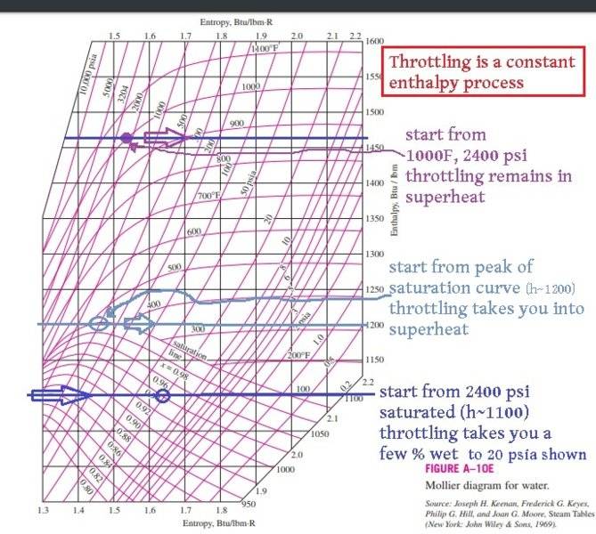

on the nuke units we rolled the turbine with 1005 psig saturated at the throttles
which is very near the peak of the saturation curve
Those nuke turbines were designed for saturated steam .
Isentropic expansion through them (straight down on Molier chart) takes you wetter, and extraction points for feedwater heating remove the moisture pushing you back up the chart along a constant pressure line toward saturation to a lower % moisture..

You will need measurement of first stage pressure and temperature to know steam condition at the blades
but you can estimate them from the Molier chart and throttle conditions
i put a green line starting at what, maybe 475F saturated?
isenthalpic expansion(throttling) horizontal to the 1 atm pressure line, looks like maybe 325F
which looks like about 113F of superheat
from there isentropic expansion(doing work on blades) vertical down to saturation maybe 190F at 5 or 6 psi??
i don't know if that will get you all the way through the HP turbine but i expect it would.
