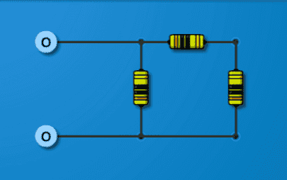

Req for parallel is 1/Req=1/R+1/R...
I have never seen a circuit like this and I'm not sure as to how I would go about calculating it since there is a resistor inside of the parallel section. All those resistors are 10 ohms.

Combine the two series resistors first (what is the equation for combining series resistors?), and then combine the two resulting parallel resistors. :smile:

Isn't there only one series resistor? I'm still not sure how to do this...
Two resistors are in series if all the current that passes through one also passes through the second.

Ok ok I see now. So the resistor on top is added with the one on the right or left then that is put in parallel with the other one... Still kind of weird though because after adding those 2 resistors, wouldn't it not be in parallel after that?

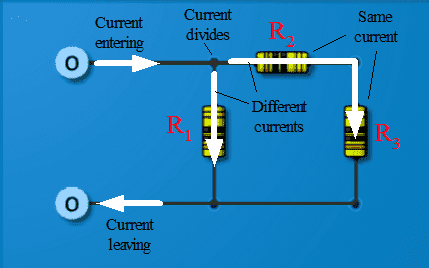

The current enters and leaves this circuit via the terminals on the left.
After adding two resistances the resultant may be in parallel with a third. Perform this simplification in steps, so you don't get confused.

Adding the two 10 ohm resistors will give series equivalent resistance Req of them. How are Req and the remaining 10 ohm resistor connected?

I've added unique identifying labels to the resistors in the figure in post #8. Can you tell us which two resistors you added together and which is the "last one" that you combined with the sum?

R3 and R2 as series then that with R1 as parallel.

I believe that you've misunderstood the problem. It is an entry level problem with three resistors, all 10 Ω. The goal is to reduce the given network to a single equivalent resistance value. It requires the concepts of recognizing series and parallel pairs of resistances and combining said pairs into single values. Eventually a single value representing the entire network's equivalent resistance is achieved.
Correct.
