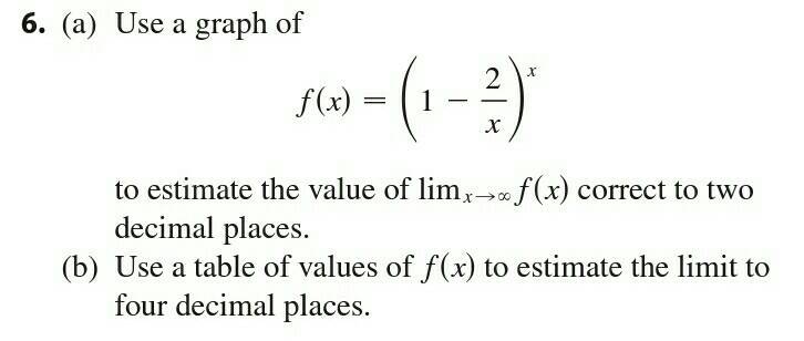

  • Textbook exercise showing f(x) = (1 - 2/x)^x, with part (a) asking to use a graph to estimate lim as x approaches infinity of f(x) to two decimal places, and part (b) asking to use a table of values to estimate the limit to four decimal places.

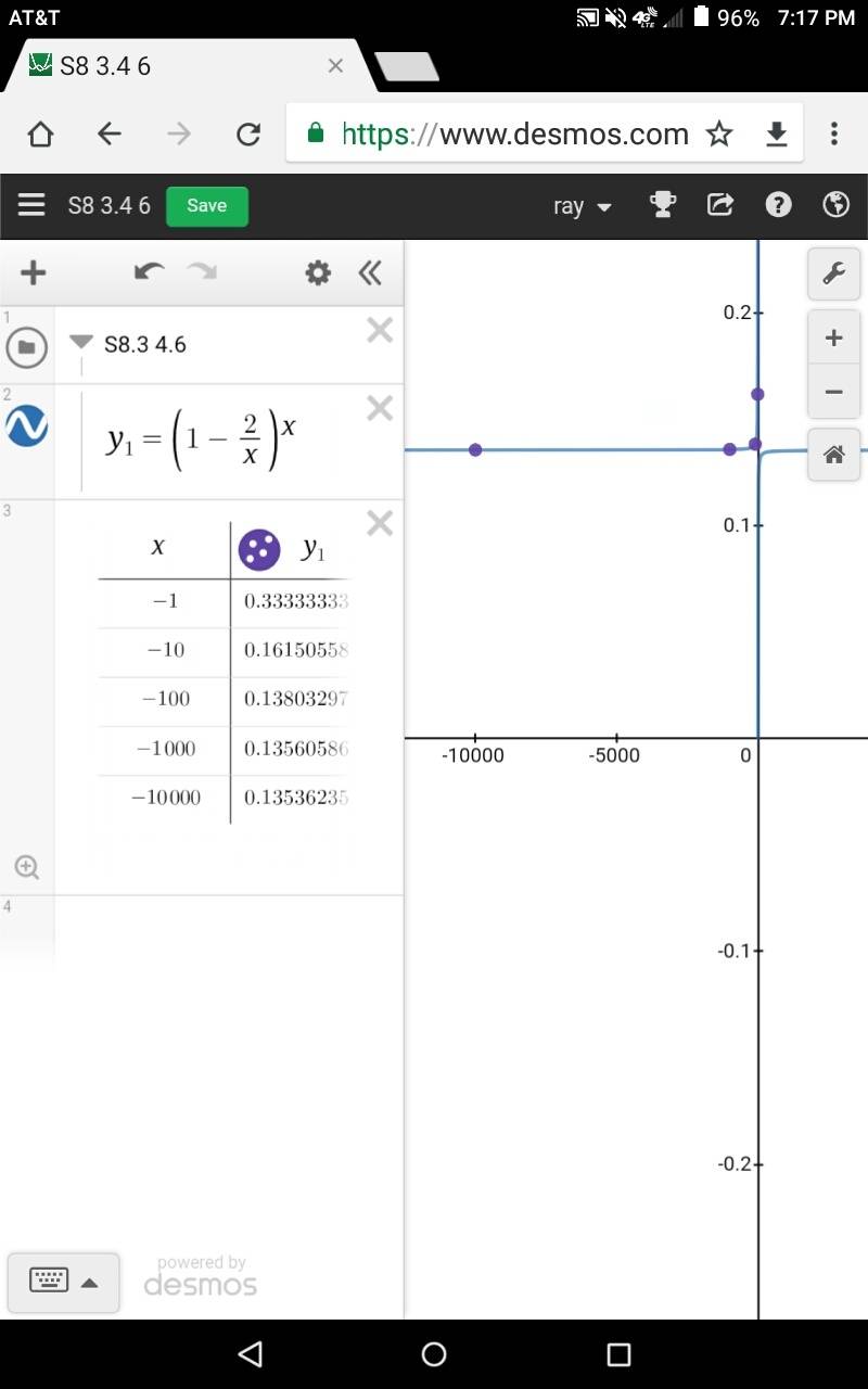

  • Desmos screenshot of the function y1 = (1 - 2/x)^x with a table of x values from -1 to -10000 and y1 values approaching about 0.1353, plotted on a graph with a horizontal asymptote near 0.135.
karush said:
Ok all I did was DesmosNot real sure how to take limit
Why are you plugging in large negative values for x? Surely for an infinite limit you should be plugging in large positive values.
As for a hint, you should use the standard limit $\displaystyle \lim_{x \to \infty} \left( 1 + \frac{1}{x} \right) ^x = \mathbf{e} $.
Ok I see what you mean
But there is no graph on the positive side
also its 2 not 1
What do you mean "there is no graph on the positive side"? Of couse there is.
also its 2 not 1
Prove It is not giving you the answer he is giving you a suggestion that you can use the limit he posted. See if there is any kind of substitution you can make to put your limit into the form he gave you.
And the graph of f(x) becomes real again for [math]x \geq 2[/math]. (Why does it "disappear?" Why does it "reappear?")
-Dan
actually I don't know why it does not graph $0\le x \le 2$
Look at the numbers. Can you divide by 0? Can you take an even root of a negative number?
For this problem it doesn't matter that "it does't graph" between 0 and 2!
Using the "Desmos graphing calculator" at [FONT=Verdana,Arial,Tahoma,Calibri,Geneva,sans-serif]https://www.desmos.com/calculator you can look at the graph at very large x and small values of y so get an idea of the values you need.
