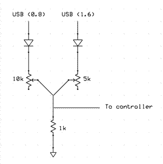

If I'm understanding you correctly you can do it with two diodes, one 1k resistor, and one 1k pot. Connect the anode of one of the diodes to one of the USB outputs. Connect the anode of the other diode to the other USB output. Connect the 1k resistor between the cathodes of the two diodes. Connect one end of the pot to ground. Connect the other end to the cathode of the diode which is connected to the USB output you want to use for the 1.6 volt. Connect the middle tap of the pot to your analog stick.
You can adjust the pot for 0.8 volts or 1.6 volts, depending on which USB output you have activated. You only have to adjust the pot once. Having both USB outputs off will give you 0 volts.

No, you only have to adjust once. The reason it works is that 0.8 is half the value of 1.6. And since the resistor and the pot have the same value, when you switch to the 0.8 USB output it will cut the current in half. So whatever voltage you have the pot set at, it will be halved also. Just use ohms law and you will see that it works. I've already calculated that you will need to set the pot at 320 ohms (as measured from tap to ground). With the 1.6 output active you will have a total resistance of 1k, so the current will be 5/1000=.005, and the voltage at the tap will be .005*320=1.6. When you swith to the 0.8 output you will have a total resistance of 2k, so the current will be 5/2000=.0025, and the voltage at the tap will be .0025*320=0.8.

if i were to get some POT's could i just connect a POT to each output and adjust each one?
Yes, but the components values would probably be different.
Circuit with individual pot adjustments. This circuit assumes that both USB outputs will not be active at the same time. If that happens, the output to the controller will be higher than 1.6 volts. However, this circuit is not as critical on component values. If you don't have a 5k pot, you can substitute a 10k pot. The reason I selected a 5k pot for the 1.6 output was so that it's set-point at 1.6 volts would be around mid range.
