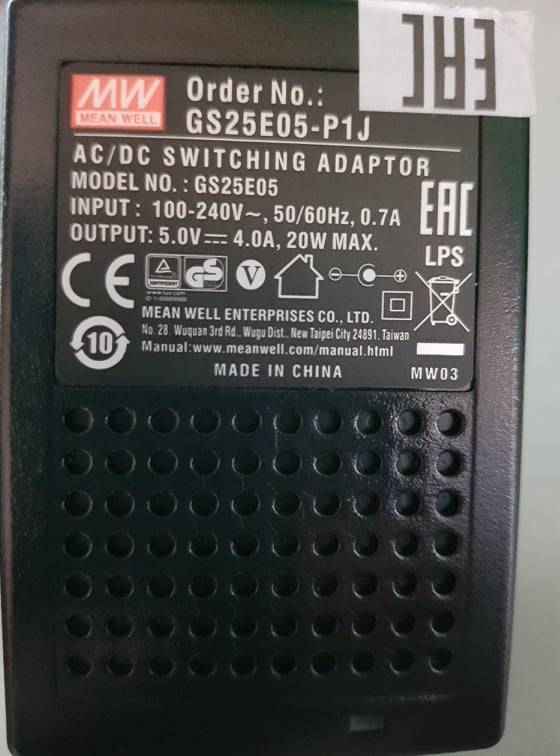

It's to power a very expensive laboratory equipment, a spectrometer so I can bring it outside with a laptop. The spectrometer says 5V, 1A at the back.
Back panel of a device with a USB port at top and a barrel DC power jack below, labelled 5V = 1A with a centre-positive polarity symbol; a plug is inserted into the jack.
Currently, It's power via Meanwell adaptor (see picture):
Label on a Mean Well GS25E05-P1J AC/DC switching adaptor, showing input 100-240V~ 50/60Hz 0.7A and output 5.0V 4.0A 20W max, with CE, GS and EAC marks.
I want very pure 5v output so it won't ruin the circuit inside. I heard ordinary USB powerbank has switching power supply, and not good as it's pure? Pure means like output from 3.7v lithium battery like used in cellphone, without any switching noises, etc.

I did. The AC adaptor for it is:
Label on a Mean Well GS25E05-P1J AC/DC switching adaptor: input 100-240V~, 50/60Hz, 0.7A; output 5.0V === 4.0A, 20W max; made in China.

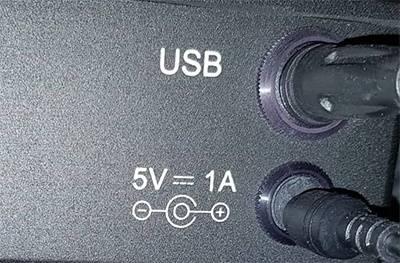

It's 1A only, the back of the spectrometer has this label:
Back panel of a device with a USB port at top right and a round DC barrel jack below; printed label reads 5V == 1A with a centre-positive polarity symbol (minus, circle, plus).
I want to run the battery pack less than 1 hour only.

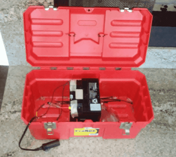

So a 12V, 1Ahr battery source would give you plenty of margin. What have you found for 12V input, 5V output DC-DC converter modules? If you use a simple 12V lead acid deep-discharge battery (like I do for my HAM radio setups), you can use a simple/cheap car battery charger to recharge the battery source...
Red plastic toolbox opened to show a 12V battery inside with wires running to a black DC-DC converter module and a cigarette-lighter style plug, with a yellow label on the front of the box.
See my last message. It's risky to use 12V to 5V DC-DC converter circuit. What if the converter get broken in the future. Then the entire 12V will get into the unit and ruin it. It's too risky to ship a $16,000 unit around the world. I want a battery pack that doesn't use any converter but just pure 5V but worry free.
And the 12v is too bulky.

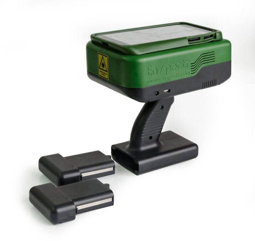

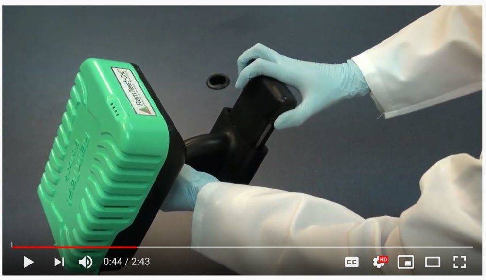

The following is another product by another company that uses the same unit but made it portable. Did you see their battery pack? It's compact and small size. What could it be?
Photo of a gloved hand holding a black handle attached to a green handheld device labelled Rainbow Test Cable, with a black grommet-like ring on the surface behind it.
Green and black handheld spectrometer with a tablet-style screen on top, a pistol grip, and a laser warning label on the side, shown beside two black detachable battery packs with metal contacts.
Remember since I didn't buy these specific products. They won't tell me what kind of battery or circuit for it. Its portable unit is $3000 more expensive.

The problem is together with the 12V battery. It's bulky. I just need something like this:
Handheld green and black device with a tablet-style screen on top, a laser warning label on its side, and two detachable black battery packs with metal contacts placed in front of it.
Could it be just small AA rechargeable batteries? What combinations can produce 5V? Maybe 3 pieces of 1.5v AA small batteries or 4 pieces? Remember I think each is only 1.2V?
Get an 8 way AA battery holder and use 8 lithium batteries with the DDR switching power supply. If the device actually draws 1A continuously you should get 2 or so hours out of them. Alkaline will be half or less life if they work at all.

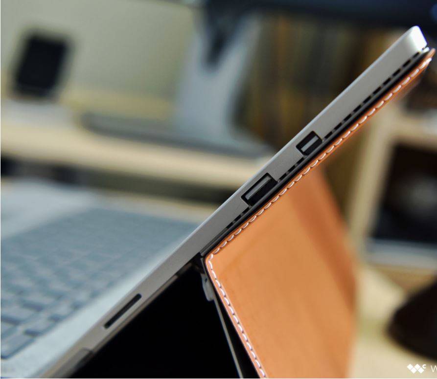

My Microsoft Surface Pro 201`7 tablet has USB 3.0 and here it is described as Maximum Current: 900mA.
https://en.wikipedia.org/wiki/USB_3.0
If the equipment draws 1A or more, the USB 3.0 has current limiter of some sort?

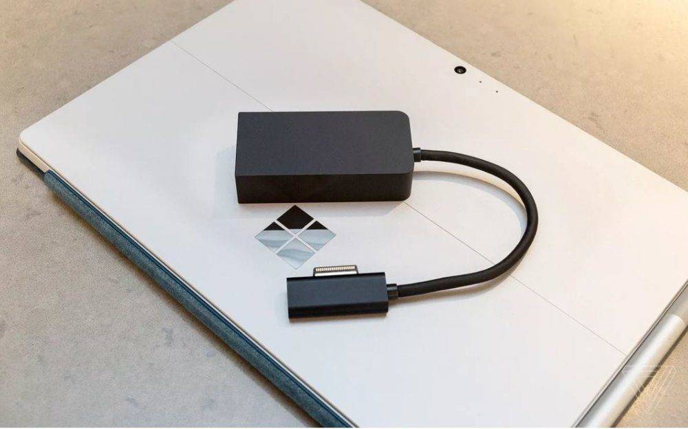

Added: I couldn't use the USB 3.0 in the Microsoft Surface Pro because it has only one USB which is to connect to the unit. So there is no 2nd USB for the power. The Microsoft Surface 2019 has this specs:
One full-size USB 3.0
Mini DisplayPort
Headset jack
Surface Connect
microSDXC card reader
But still I want to know what would happen if say an average PC USB is only say 1A and you draw 4A, what would happen to the USB? Just for stock knowledge.

I'm not seeing the need for completely ripple-free voltage. The Meanwell GS25E05-P1J is a switching power supply rated 5V, +/-5% load regulation, 0 to 4 amp output with up to 50 mV peak-to-peak ripple/noise. The spectrometer requires 5VDC at 1 amp.
Wouldn't any commercially available USB powerbank capable of supplying 5V at 1A at 50 mVp-p or less ripple (with enough mAhr capacity to supply power for the required amount of time before recharging is needed) do the job?

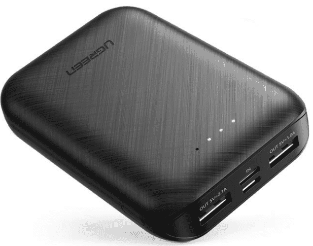

Well: sorry to say this, but your very best (!) choice is exactly an USB power bank: preferably with a 2A output port.
It is also the most safe for this role.
If you are worried, then pick one which can manage multiple outputs simultaneously and connect a mobile phone (or any useless USB gizmo) on the other port. That'll do as an overvoltage protection.
Any homemade stuff will be just less safe.
If you want to give even more security to the thing then get something like this: it is unnecessary, but can give you the feeling of security anyway. By the way: above that 5V input that is an USB in- or output?
