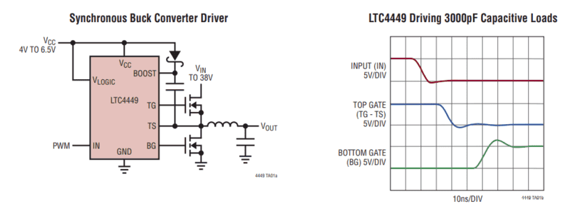

I have designed a circuit utilizing a LTC4449 high speed n-chan mosfet driver.
I am running the Vcc at 5 v from a 0.5a linear regulator 7805 type.
The switching voltage is 24v from 600w smps.

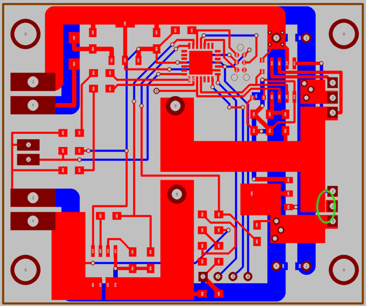

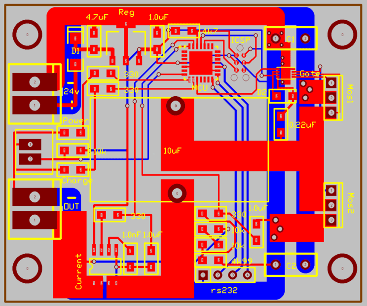

I am using this exact layout. The gate driving on the bottom mosfet seems to be working properly but the gate drive on the top does not. I think it is an issue with the boost circuitry.
The Schottky diode I am using is ACDBN1100-HF 100V
The boost cap is C1206C224M5UAC7800 0.22uF
I have tried several input pwm frequencies from 15k to 250k with no change.
It is my understanding that a high gate singal on the top mosfet is going to be 24v plus 5v. When I measure boost pin voltage it is just around 5v. Should it be 24v or 29v?

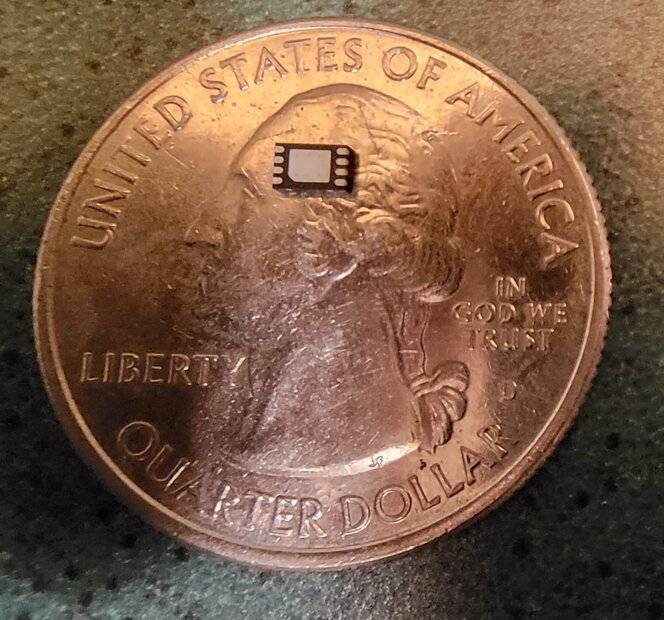

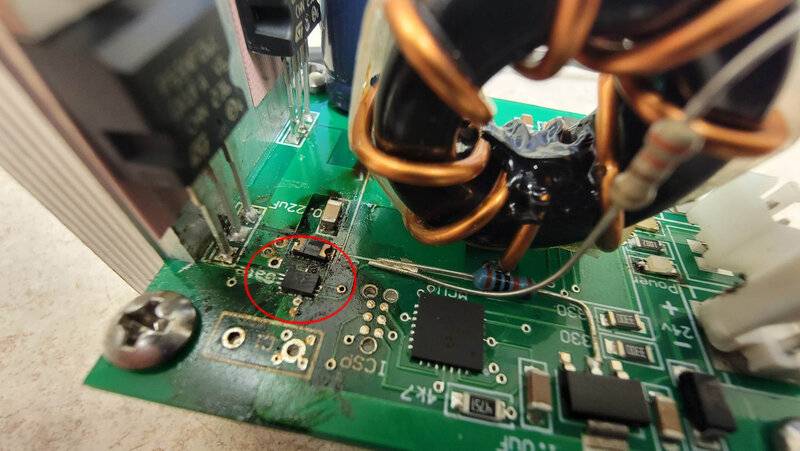

This component is a 2mm x 3mm DFN so it is ultra small and hard to work with. I have resoldiered it serveral times in an attempt to get this circuit working correctly and replaced it once. It appears to be soldered properly.
Thanks in advance for everyone's help.

The boost voltage (stored in the capacitor) should be about 0.5 volt less than Vcc, measured relative to TS.
techn0 said:
TL;DR Summary: Need help getting high side gate working properly.
How did you measure this? With an oscilloscope? The voltage at TS will switch between about 4.5V and 28.5V. The voltage across the capacitor will be 4 - 4.5V.

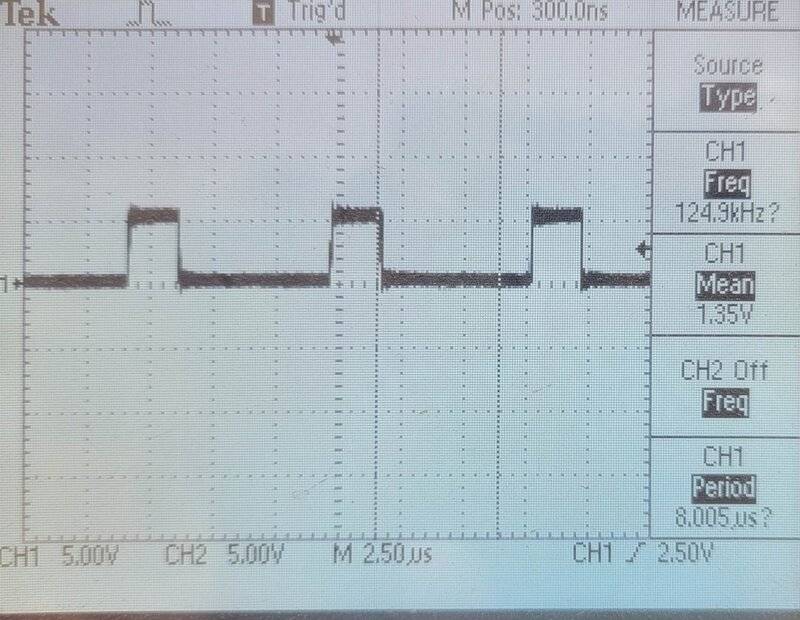

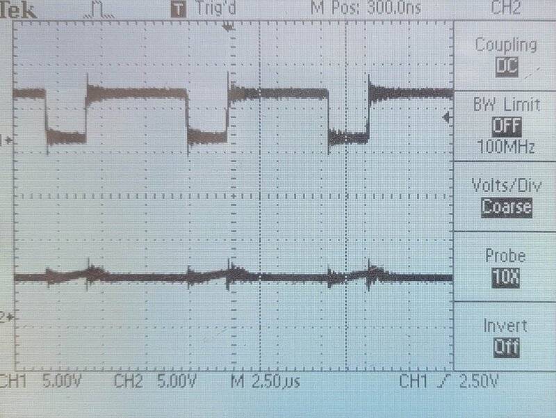

Here are some pictures of the signals. Running at a freq of about 125k this attempt.
Input:
Gates Low & High out:
As you can see there is something wrong with high side.

I received the new mosfets 0.22uf Cap and Shottky Diode. I have the exact same results as before.Driver.jpg Driver solderied.jpg Curcuit.jpg
High side gate still does not work. I am so frustrated with this thing. I have re-soldered the gate driver probably a hundred times now. Only thing that changes is sometimes the low side does not work too.
The boost cap will be charged to +5V, but the low voltage terminal will switch between 0V to +24V as the output MOSFETs switch. The higher voltage terminal of the boost cap will switch between +5V and +29V.
techn0 said:
I checked voltage on both sides of the schottky diode and it is the same as the voltage of the regulator 4.95v
The boost capacitor can be seen as a charge pump or a floating local power supply for the high-side gate drive.
The capacitor is referenced to the source of the high side MOSFET. That boost capacitor charges through the diode to supply voltage while the output is low. The cap then provides positive power to the high-side MOSFET gate during output high.

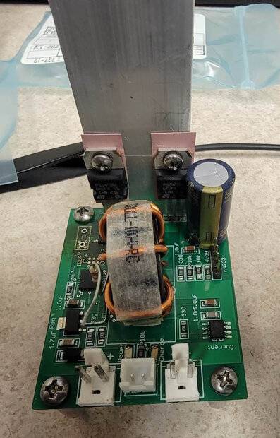

Looking at your pictures, I assume the big electrolytic capacitor is a reservoir for the 24 volt MOSFET drain circuit.
I see no bypass capacitors on the +5 volt Vcc near the gate driver. Maybe they are under the PCB?
The gate driver will not work well without sufficient fast ceramic bypass capacitance. The inductance of the tracks will be too much when Vcc must provide about one amp for fast switching of the MOSFET gate capacitance.
At high switch rates, you will need a significant Vcc supply.
I would expect a solid ground plane under the PCB, near the gate driver IC, and the lower MOSFET source.
Please provide a schematic that includes the supply bypass and reservoir capacitors.
Yes the large cap is the 24v rail for the mosfets. The current pcb does not have any bypass cap near the gate driver. This is my first time using a gate driver of this sort so I did not know to use something. I will solder something in place tomorrow to give that a try. It would be miraculous if that makes this circuit work. Going to start with a 10uF ceramic unless you think some other value would be better.

I ran a thicker wire from the regulator to the via near the gate driver and added a 10uF ceramic at that via. Nothing changed. High Gate still completely useless.

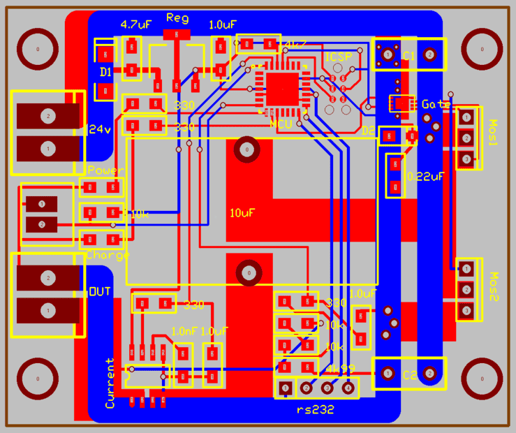

Here is original PCB Top traces and bottom. I do not do schematics I just draw the PCBs.
Mods tried from orignal PCB are 10k PWM pull down
High current trace from reg out via to vcc via near gate driver
10uF cap placed right near gate driver
New mosfets with better low gate on specs
and of coarse resoldering and or replacing the gate driver way to many times
Nothing has improved original wave forms pictured above.
I have the bottom solder pad on the gate driver grounded. Should it not be?

I have found no information that says the DFN8 package thermal pad is internally connected to a terminal. Since there is no connection advice, I guess it must be an electrically floating thermal pad.
You should be able to debug the PCB without the power MOSFETs installed.
I cannot identify pin #1 on the NCP3420 gate driver layout.
Why are two pins tied together? Does it disable high side?
Why is the regulator ground not connected to Pgnd?
Edit: The PCB layout was for the LTC4449, not the NCP3420.
This is an LTC4449 not NCP3420. Pin 1 is lower right
Regulator ground is connected.
Vcc and Vlogic are tied together in typical application in datasheet.
