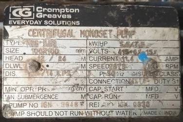

Pump is supply fluid to the 35 nozzles through 3 inch pipe and manifold.At nozzle the pressure is 32 m and pressure at pump outlet is 30 m .The flow rate required at nozzles is 500 lpm. Pump can deliver 860 lpm at 24 m head.pump size 100x100 mm

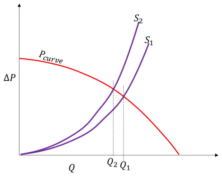

Your pump performance spec is probably at operation point of best efficiency (BEP). The actual pump curve is something like the following (red line). The purple lines are two theoretical system curves. ##S_1## is less restrictive than ##S_2##.
Graph of pressure head change ΔP against flow rate Q, with a red downward-sloping pump curve labelled P_curve and two rising purple system curves S_1 and S_2; S_2 is steeper, and dashed verticals mark Q_2 and Q_1 where each system curve meets the pump curve.

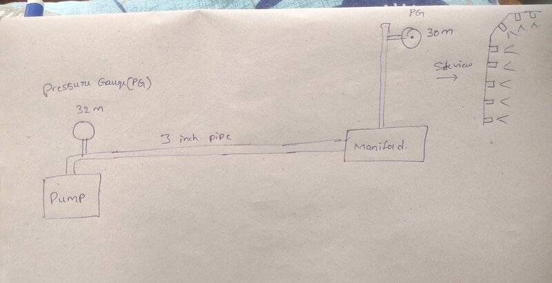

This part of the reply does not make sense to me. Show us a simple diagram of the piping system.

I have shown side view the nozzles are connected to tube which is connected to manifold

What are the inlet conditions of the pump? You just have a box drawn. Is it a tank?
Inlet is connected to tank

Yes. But If you take some nozzles out ( blocking them) the purple curve I show gets steeper, reducing the flow rate of the pump. But… with an incompressible flow and no place for flow to go elsewhere…what goes in must come out. That is that.
