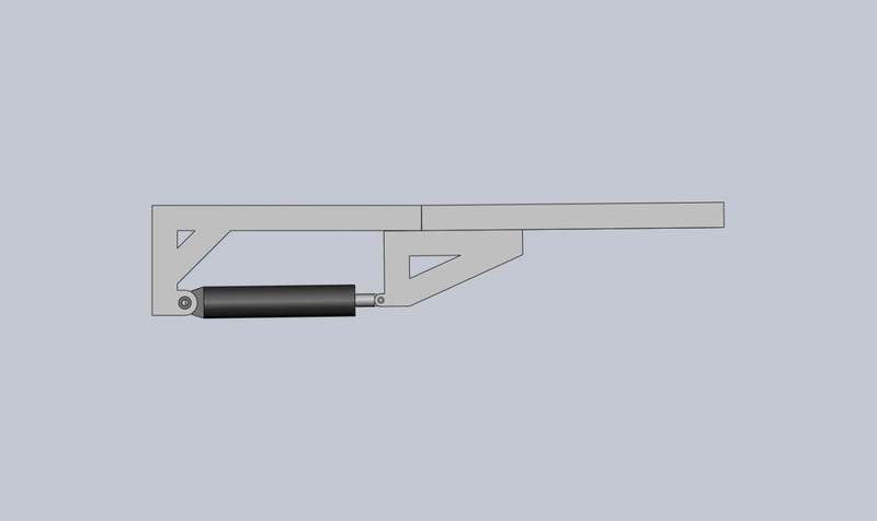

Hello All,
I am building a project where I am looking to have a pnuematic cylinder mounted underneath a ramp and push up a gate that is hinged, to 90 degrees, however I am struggling on how to get this to properly function. From center to center of the 2 clevis mounting holes, on the cylinder, is 15 3/8" (in the closed position). The cylinder has a 7" stroke, therefore in the open position, from center to center of the clevis mounting holes is 22 3/8". I am not sure where the cylinder needs to be mounted underneath in order for the hinged gate to be pushed up to a 90 degree, at a full stoke and parallel when fully retracted.
I have pictures of what I am trying to accomplish but it is 10MB in size so I am not able to upload it. Pictures are woth a thousand words :-) If you think you can assist me, I will be more than happy to send you the pictures (6 in total)

I don't think that where you mount the cylinder is terribly important. The length of the attachment bracket on the rod end will determine the starting and ending positions of the gate.

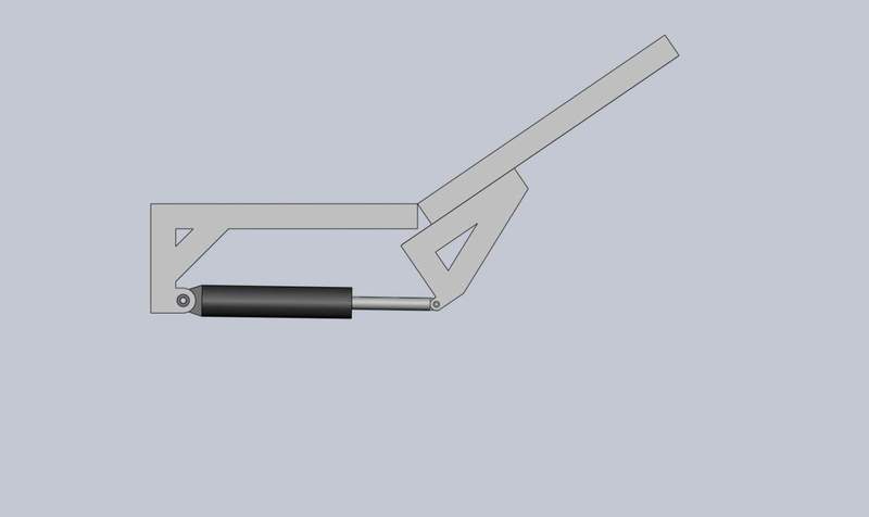

I've been mucking around with it for about 11 hours and no success. If I munt the cylinder so that it is at Full stoke and the gate is at 90 degree, then when it goes to close, it is fully retracted and the gate is at about a 20 degree angle.

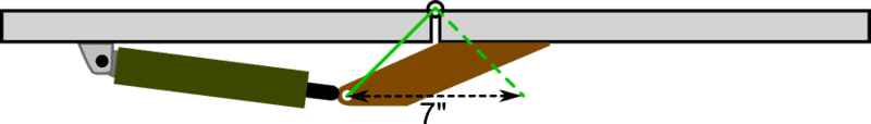

Since you need to move it ninety degrees, I look at it as an isosceles right triangle. The equal length legs denote the lever's starting and ending points, and "C", the junction of the legs, is the pivot point. The hypotenuse is the cylinder's travel, seven inches, therefore the length required for the arm is 4.95 inches (from center of hinge pivot.)
This is just a rough sketch, not to scale.

By creating that distance from the bottom of the gate it increases mechanical advantage (i.e. the further away you are from the door hinge, the easier it is to push the door open). The cylinder is probably best parallel to the ramp, although you want to make sure that the joint between the cylinder rod and the gate has enough room for the gate to go to 90deg.
