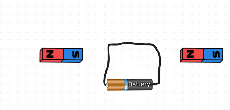

this what i have right now the black represents a wire. i don't think this looks right at all. i also need help finding something i can put under the battery to allow it to rotate.
Could you turn the experiment on its side and suspend the rotor using a thread?
possibly but the thread would get tangled no?
grade11studentgoaat said:
TL;DR Summary: i need help making a motor
What reading have you been doing about building simple DC motors? Have you learned about using a commutator yet?
we havent been doing them in class he just gave us this assigment as a extra thing to do over the winter break. and no i havent learned about a commutator
Well, you should do some Google searching for simple DC motor projects to be sure you get some important things right. What you sketched so far will not work.

okay i will thank you!
