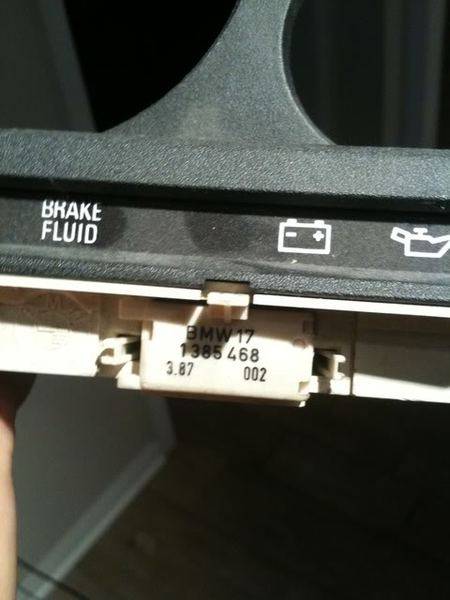

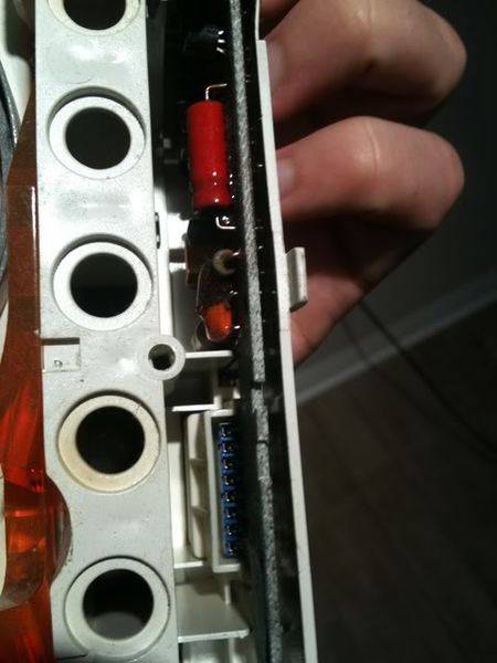

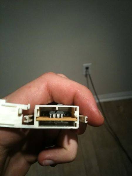

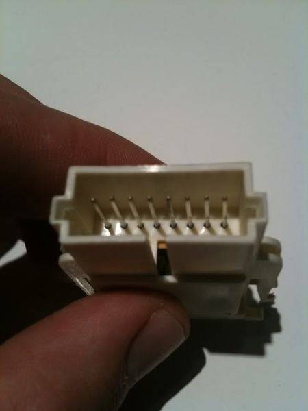

I think I have made a discovery! I know what is called the "coder plug" on the cluster effects how the cluster displays the tach because the car is a bmw e30 (e30 is the generation of 3 series bmw's from 1984-1991). The e30 came in 4 and 6 cylinder models, the tachometer will display correctly in either the 4 or 6 cylinder models IF you swap the correct coder plug (whole cluster replacement not required). Furthmore for this swap, if you start with a 6 cylinder model, and swap in a 4 cylinder coder plug it will show half of what an tach rate the 8 cylinder is running at.
Thus if we can figure out how, all i really need to do is modify this coder plug. So i decided to dismantle it and took pictures, to my surprise all it is, is one chip, that's it. Question is what chip do i replace this with now or modify this current one to display half? The code on top of the chip reads "HML 087 8701" can anyone identify it? Mind you this is a 6 cylinder code plug so me running this would be off by 3/2 i think? I can very easily and cheaply get a 4 coder plug if it makes this easier.
Pictures (last two are most important):

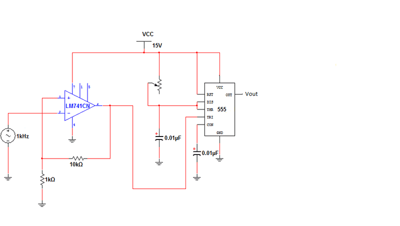

Here is simple frequency divider using LM741CN and 555 timer in monostable mode.
I have made this divider.
But I want to know what are the applications of frequency divider? When to use it? Kindly bring this into my knowledge.
Thanks

I had someone with the 4 cylinder version code plug take a picture of theirs (this one reads twice as needed with a 8 cylinder swap). The chip code on this one is:
HML
087
9119
[PLAIN]http://img593.imageshack.us/img593/1656/4cyl.jpg
[PLAIN]http://img257.imageshack.us/img257/3930/4cyl2.jpg
Can someone chime in and identify these chips, so i can modify or replace them?
