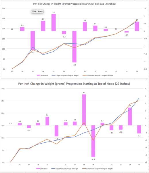

Hello,
I have a tennis racquet that has a certain weight distribution that makes it play very well. Due to quality control issues from the manufacturer my second racquet of same make and model has a very different weight profile, making matching difficult.
I'd like to determine the weight distribution of the target racquet on an inch-by-inch-segment basis. I'll do the same with the second racquet, adding weight where needed to match the target racquet (the second racquet is far lighter than the target, so this should generally work- and I recognize there may be cases where I would need to remove weight from the second racquet; I'm ok with this problem).
How do I measurement the weight distribution per one-inch segment?
Thanks in advance...

One more point - I don't need to know the actual weight per-inch segment, I just need to know they are the same between the two racquets. I tried stabilizing one end of the racquet and moving a scale along the length of the racquet, moving in one-inch increments. This is essentially the same approach as the @sandy stone water in the cup method.
Doing this with both racquets, I can see variations in the weight reported on the scale, which are presumably the areas where the weights differ (see attached screenshot of results). I just don't know how to calculate how much weight to add to achieve an end to end match. Would this approach work?

I can see there may be some confusion regarding my initial post. I had R1 and R2 matched in weight, balance (CM), and swingweight (MI) (specs below). Although specs matched, they clearly did not feel the same (in the ways noted prior). I recast the problem as a clean slate, with R1 as the target and R2 in stock form, to take a fresh look at how folks in this forum may approach the goal.
I have also adjusted the weights of R2 further, by feel, to try to get a match - and did add too much weight, making it too heavy, as part of this (to test the boundaries). I wasn't able to find the sweetspot to match the two.
You mention "impulse force" when exploring the role of stiffness - and more broadly, the behavior of the rigid body. Perhaps this is already clear and considered, but the feeling is different independent of actual impact... simply swinging the racquet in the air, even without much force, the difference can be felt.
