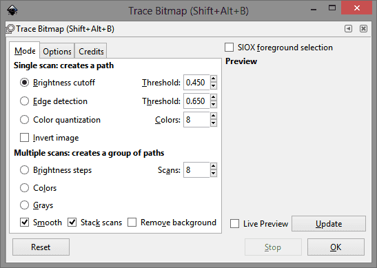

@john101 I used Krita and GIMP but I don't know what color correction I need to do in them, learning curve is high in these software.
Anyhow I used Inkscape to solve my problem.
This is what I did, maybe of some use to someone.
Steps :-
1) :- Convert the PDF to JPG or PNG(http://pdftoimage.com/). Simply importing a PDF in Inkscape is doable but this method does not work with it. (Please let me know if you know)
2):- Drag the Image in the on a new inkscape document. Select the option that says "Import image with default dimensions"(something like this).
3) :- Then go the path > trace bitmap.
4) :- Then just select the 'Ok' option and wait for the magic to happen. Default settings work for me but you might have to adjust them.
This step weirdly does not work if the PDF is directly imported in Inkscape.
5) :- Then convert it back to PDF. http://jpg2pdf.com/
I tried it with some different types of images and it does not work properly with all kinds of images.
