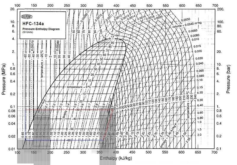

I am trying to reconcile HFC-134a refrigerant with the 2nd Law of Thermodynamics. I shouldn't be able to extract useful work from a single temperature reservoir.
Suppose I use a refrigeration / heat pump cycle with HFC-134a as shown below.
-Compressor adds 29 kJ/kg increasing refrigerant temperature from -60C (saturated vapor) to -18C
-Hot side heat exchanger is divided into 3 sections -- two variable temperature sections and one constant temperature section.
-The log mean temp of hot side section 1 is -24C, temp of hot side section 2 is -30C, and log mean temp of hot side section 3 is -45.3C
-If 3 carnot efficiency heat engines are connected across the 3 hot sections to the -60C cold section, they extract 30.96kJ/kg of useful work.
Since the compressor only adds 29kJ/kg of energy, but the useful work of the heat engines is 30.96kJ/kg, won't this mean there is 1.96kJ/kg energy deficit on the cold side of the loop before the compressor? Can't this cold section absorb heat from an outside heat reservoir that is greater than -60C to complete the cycle?

It is not clear to me what is being done here. Can you please provide a schematic diagram of the process? Also, are those log-mean temperatures or log-mean temperature differences?
Hi,
Where do you get the numerical data for your cycle ? Surely not from the graph ?

I'm going to redo my calculations with numbers from the chart you linked. So far, I've got:

The pressures don't seem to match what the diagram shows.
I'm trying to keep the compressor input at or below the original value of 29 kJ/kg while using values found in the charts via the link.
I'm still calculating 1.5% more useful output from the 3 Carnot heat engines than input to the compressor...

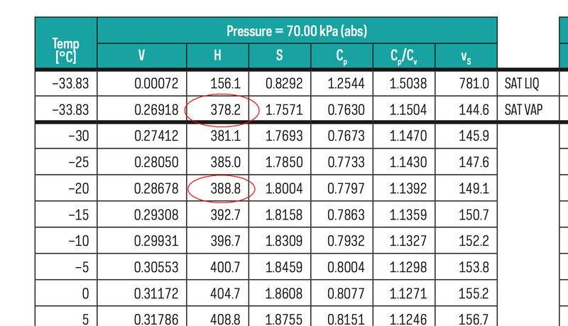

BvU said:
1.5 % is not so bad when reading from a graph...
I got those values from the link you posted.

Using log mean temperatures assumes the heat capacities are constant. I agree with the others: your calculations have too much inaccuracy.
I calculated the energy transfer through heat engine 1 from the difference between the enthalpy at the compressor exit and the enthalpy at saturated vapor...

The problem is just roundoff error. The entropy of the superheated vapor at -20 should be the same as that of the saturated vapor at -60, 1.8024 rather than 1.80. I used the latter value and got a match on the work.
Here is the calculation for the Carnot engine(s):
Hot Side refrigerant in:
Temperature -20 C
Pressure 70 kPa
Enthalpy 388.8 kJ
Entropy 1.8024
Hot Side refrigerant out:
Temperature = -60 C
Pressure = 70 kPa
Enthalpy = 124.0 kJ
Entropy = 0.6873
Hot Side refrigerant change in enthalpy = ##\Delta H_{hot}=Q_{hot}=-264.8 kJ##
Hot Side refrigerant change in entropy = ##\Delta S_{hot}=-1.1151##
Temperature of cold side refrigerant = T_{cold}=-60 C = 213.2 K
The entropy balance of the Carnot engine working fluid is: $$-\Delta S_{hot}+\frac{Q_{cold}}{T_{cold}}=0$$where ##Q_{cold}## is the heat transferred from the Carnot working fluid to the refrigerant on the cold side. This gives ##Q_{cold}=237.7\ kJ##
The energy balance on the Carnot engine working fluid is:$$-Q_{hot}-Q_{cold}=W=264.8-237.7=27.1\ kJ$$

I’ve calculated that only edit:237.27kJ/kg is returned to the cold side via the 3 carnot heat engines (since 27.53kJ/kg is extracted as useful work), so to complete the refrigeration cycle where is the other 0.43kJ/kg coming from? If it’s absorbed from the environment how do we reconcile it with the 2nd Law of Thermodynamics, since we shouldn’t be able to convert heat to work with a device that works by extracting heat from a single temperature reservoir (ie the environment).
I showed that your 237.37 is inaccurate, and that the correct value is 237.7. You integrated CpdT/T to get the hot side entropy change (assuming constant Cp), but the thermodynamic table clearly gives the overall entropy change directly (which is needed to get the cold side heat return of the engine(s)). You didn't have to integrate to get the entropy change, and, if you had used the values from the table, you would have gotten the correct result.

For heat engine 1, I noted the 10.6kJ/kg change in enthalpy between 70kPa -20, and Sat Vap 70kPa -33.83. So 10.6kJ/kg went into the hot side of Carnot heat engine 1. Next I found the log mean of the temperature range (-20C to -33.83C) on the hot side of the heat engine was -26.98C. Next I calculated the carnot efficiency of a heat engine with a -26.98C hot side and a -60C cold side-- and that is 13.413% efficiency. Next I calculated the useful work from the heat engine was 1.421kJ/kg. To find the heat returned to the cold stream I would subtract 1.421kJ/kg from 10.6kJ/kg to arrive at 9.179kJ/kg is returned to the cold stream through heat engine 1.
Can you please point out what stage of the calculation I made my error?
Why did you use the heat capacity and log mean temperatures if you could get the entropy change directly from the table? You do realize that using the log-mean temperature is tantamount to assuming that the heat capacity is constant, right?
The entropy change is 1.8004 - 1.7571 = 0.0433. So the heat returned to the cold stream should be (0.0433)(213.2) = 9.23 kJ/kg. The hot side heat removal was 10.6 kJ/kg. So the work should be 1.37 kJ/kg, and the efficiency should be 12.9%. By the way, the 10.6 is not precise enough to allow us to express the cold side heat removal or the efficiency to 3 significant figures..

For that "engine," both methods will give the same answer (of course). However, the calculated values will depend on what one uses for the absolute Kelvin temperature at 0 C (273., 273.2, 273.15, or whatever). It also depends on what value the developer of your table used. If you divide their enthalpy of vaporization by their entropy of vaporization at -20 C, you get a temperature of 253.18 K, implying a value at 0 C of 273.18.
The point of. all this is that (1) the table may not have enough precision to resolve the difference you are looking for and (2) using the log-mean temperatures for engines 1 and 3 results in inaccuracy, by inherently neglecting the effect of temperature on heat capacity.
