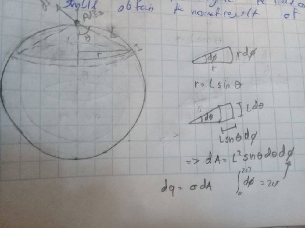

The electric field outside and an infinitesimal distance away from a
uniformly charged spherical shell, with radius R and surface charge
density σ, is given by Eq. (1.42) as σ/0. Derive this in the following
way.
(a) Slice the shell into rings (symmetrically located with respect to
the point in question), and then integrate the field contributions
from all the rings. You should obtain the incorrect result of
##\frac{\sigma}{2\epsilon_0}##.
(b) Why isn’t the result correct? Explain how to modify it to obtain
the correct result of ##\frac{\sigma}{2\epsilon_0}##. Hint: You could very well have performed
the above integral in an effort to obtain the electric
field an infinitesimal distance inside the shell, where we know
the field is zero. Does the above integration provide a good
description of what’s going on for points on the shell that are
very close to the point in question?
Coulomb's Law
Handwritten sketch of a sphere with a point at the top, a ring at polar angle theta with radius r = L sin theta, and a thin strip of width L dtheta and circumference element L sin theta dphi, with the area element dA = L^2 sin theta dtheta dphi and integral of dphi from 0 to 2pi.
Hi! I need help with this problem. I tried to do it the way you can see in the picture. I then has this:
##dE_z=dE\cdot \cos\theta## thus ##dE_z=\frac{\sigma dA}{4\pi\epsilon_0}\cos\theta=\frac{\sigma 2\pi L^2\sin\theta d\theta}{4\pi\epsilon_0 L^2}\cos\theta##.
Then I integrated and ended up with ##E=\frac{\sigma}{2\epsilon_0}\int \sin\theta\cos\theta d\theta##. The problem is that I don't know what are the limits of integrations, I first tried with ##\pi##, but I got 0. What am I doing wrong?

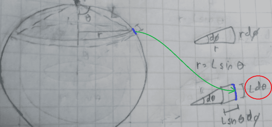

Handwritten sketch on grid paper of a sphere with a cap angle theta, radius r, and a small surface element; right side shows a triangle with rdφ, r = L sin θ, and a circled L dθ with L sin θ dφ.
I believe the only mistake you made was in your expression for the length of the blue line. See if you can show that it is ##\frac{L}{\cos \theta} d\theta## instead of ##L d\theta##.
Also, make sure you have the correct limits of integration.

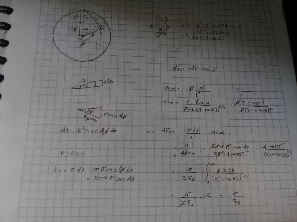

This is what I did, I don't know if I was right at saying that the distance from the center to the point is also R, but I've made a mistake, since I didn't get the correct answer.
Handwritten derivation on squared paper: a sphere sketch with radius R and distance L, the law of cosines for L squared, a dE2 integral over a spherical shell with charge density sigma, and a final result of sigma over epsilon zero.
I don't understand why it is ##\frac{L}{\cos\theta}d\theta##. I tried to show it by trigonometry, but I couldn't.
what you do is almost correct, except at the point where you calculate ##\cos\alpha## where I just can't understand what you doing there.
It is easy to see that the triangle containing ##\alpha## and ##\theta## is isosceles so it is ##2\alpha={\pi-\theta}##

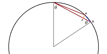

Geometry diagram of a circle with a central angle θ at the centre and a chord from the top point to a point on the lower-right arc, with a small triangle labelled a, b and c near the arc, angle θ marked at the right end.
Consider right triangle ##acb## where the right angle is at ##c##. Note ##ac \approx L d\theta##. Show that angle ##cab## can be taken to equal ##\theta##.
So indeed both so of the triangle at R? I did the correction and as you, ended up with ##E=\frac{\sigma}{2\epsilon_0}##. Why it is wrong?.
From that picture, I can say that ac is a proyection of ac, right? so ##ld\theta=ab\cos\alpha## thus ##ab=\frac{l}{\cos\alpha}d\theta##, where ##\alpha## is the angle ##cab##, I have no idea of how ##cab## could be equal to ##\theta##.
