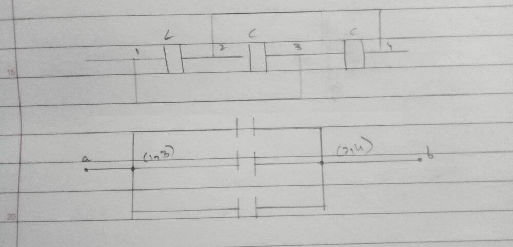

How to simplify this capacitor circuit?
21 replies · 4K views · last reply
Frigus
337
163
Find the equivalent capacitance.
Ceq(parallel)=1/C₁+1/C₂ +......1/Cn
Ceq(series)=C₁+C₂ +.....C₃
I tried to find logic behind how do we simplified the circuit as given for 2 hours and I unable to find any clue.
I can do it just by following rules but I am unable to get intuition.
I tried to make sense of it but how can we even make two points as one.

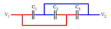

Let's clean up your drawing just a bit:
Circuit schematic of three capacitors labeled C1, C2 and C3 along a horizontal wire, with C2 and C3 joined by an upper wire loop and C1 and C2 joined by a lower wire loop.
Here's a useful "rule of thumb" for finding components that are in parallel. If you can draw a closed path through the two components using only the components themselves and the wire paths of the circuit, and NOT passing through any other components, then those two components are in parallel.
Consider ##C_1## and ##C_2## in the diagram above. We might draw such a closed path as follows:
Circuit diagram with three capacitors labelled C1, C2 and C3 on a horizontal wire, with a red loop path drawn through C1 and C2 and back along the lower wire.
Note that the loop in red transverses only the two components in question and the connecting wire paths. Thus ##C_1## and ##C_2## are in parallel.
Can you draw a similar loop for ##C_2## and ##C_3## (Or even ##C_1## and ##C_3##)?

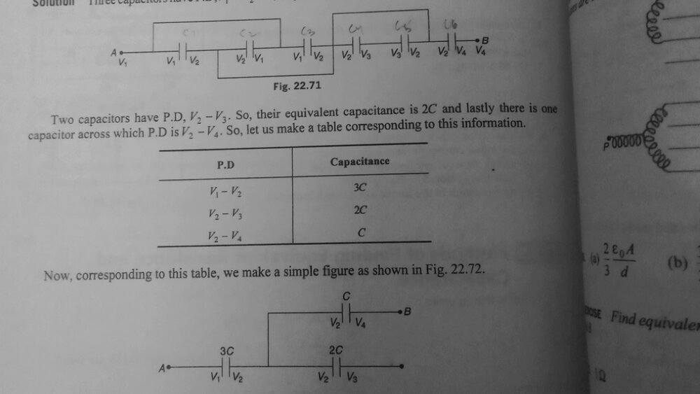

Thanks to all of you for helping me,
I am studying from a book where they are solving capacitor Circuit using "Method of same potential" and I have 2 doubts about that method and that are
• How do we know that potential difference across C₄ or C₅ is different from potential difference across C₁ or C₂ or C₃,I can figure out how C₁,C₂ and C₃ have same potential.
•after finding all the capacitors that are in parallel how do we simplify the circuit further.

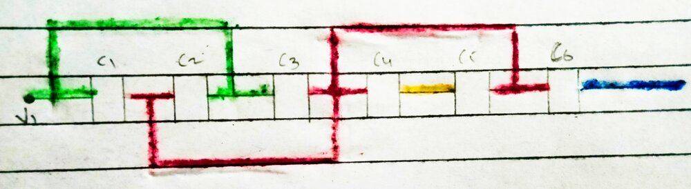

Since any contiguous wire network must be at the same potential throughout, you can identify "islands" of same potentials through the simple trick of coloring the contiguous paths with different colors. You could also simply place labels along the paths, but you may find the "coloring method" to have more visual impact, making results more obvious.
So for your circuit you might take out your highlighting pens and trace over all contiguous wire paths that you can find:
Circuit diagram of three capacitors C1, C2 and C3 in a row between terminals V1 and V2, with wire paths coloured red and blue to show connected potentials.
Looks like just two separate potentials suffice for the entire circuit.

Once you've identified parallel components it's time to re-draw your circuit to make the layout simpler to interpret. For example, you've found that capacitors 1,2 and 3 are in parallel. Redraw them to show this clearly:
Circuit diagram of three capacitors C1, C2 and C3 drawn in parallel between two vertical plates, with green wires joining their left ends and red wires joining their right ends, and a dashed line continuing to the right.
Do the same for the others, connecting the groupings appropriately according to your color scheme.

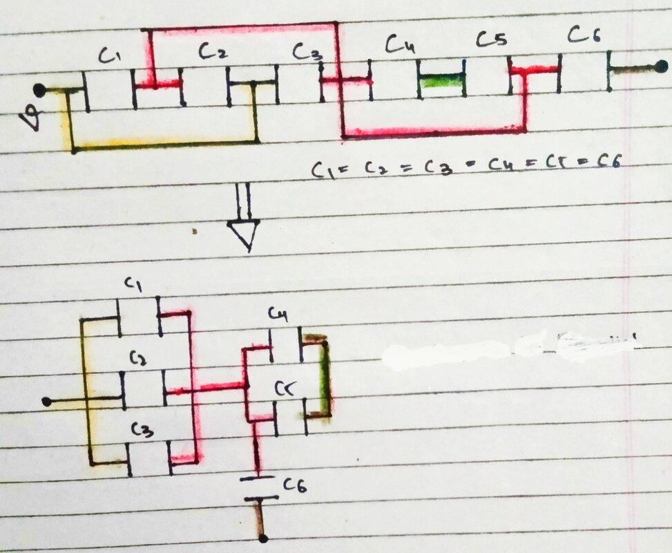

I tried to solve the circuit please check it if it is correct or not.
  • Hand-drawn capacitor network: six capacitors C1 to C6 in a top wiring diagram with equal values stated, and below it a simplified rearranged diagram with the same labels, colour-highlighted wires.
Okay, you're making progress. Your simplification of the drawing is good, but let's just touch it up a tad:
Circuit schematic of six capacitors C1 to C6 with a green input terminal on the left and a blue terminal at the lower right, with C4 and C5 joined by yellow wires forming a loop.
Take a look at the ##C_4## ##C_5## subcircuit. What effect do you think this subcircuit will have on the overall behavior of the circuit? Hint: how many wire paths lead to this subcircuit? Can current flow into and out of it?

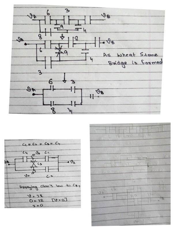

I tried to apply ohm's law on C₄₅ and after completing the loop potential difference came out to be 0 so V term in ohm's law became 0 and due to which I understood that current is 0 But their is some energy stored in capacitor which is the purpose of connecting it to circuit then why we neglect it.
Honestly speaking while I was simplifying capacitors I just connected them just to match the colours across them but I didn't understood why I have done that and also I can't understand how do we knew that which capacitors are in series in circuit like this,if it is simple circuit then we can clearly see that equal current will pass through it but in this it seems chaos.

There will be no energy stored in ##C_4## or ##C_5## since no current will have moved in it. Those capacitors are bypassed by the short circuit which will carry any current past them.
Thanks 😊.
Same colors mean same potential. All points with the same potential can be considered to be the same node, so by connecting the capacitors according to the color scheme you've maintained the circuit topology (how things are connected) despite rearranging the layout visually.
The rules for parallel and series connections for components are fairly simple. If you go by the color scheme, components that share the same two colors on their leads are in parallel. If one color connects just two components then they are in series (In our example the yellow color is shared only by ##C_4## and ##C_5##).

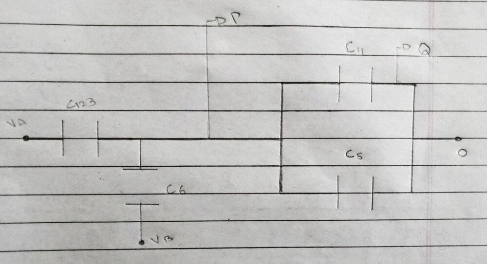

If I try to apply ohm's law then there is some current as we can see that V term is not 0 as P wire has some potential and Q wire is at 0 potential and their is always some resistance so we get some some current.
Handwritten capacitor circuit diagram with terminals VA, VB, O, P and Q; capacitors labelled C123, C4, C5 and C6, with a ground symbol and a wire running from P down to the main line.
I can't figure out what is wrong in this.

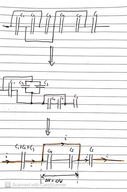

This is how I would think of redrawing the circuit:
Hand-drawn capacitor circuit on lined paper in three stages: original network of C1 to C6, an intermediate redrawing with C2 and C3 grouped, and a final simplified circuit with C1+C2+C3 in series with a loop containing C4 and C5, then C6, with current paths in orange and the label ΔV = 0V across C4 and C5.
I have coloured the path of the current through the arrangement in that lower redrawing in orange. You can also deduce that the potential difference across ##C_4## and ##C_5## is zero, since they are connected in parallel with a loop of zero resistance.
Hopefully that is now sufficient to do whatever analysis you were after!
