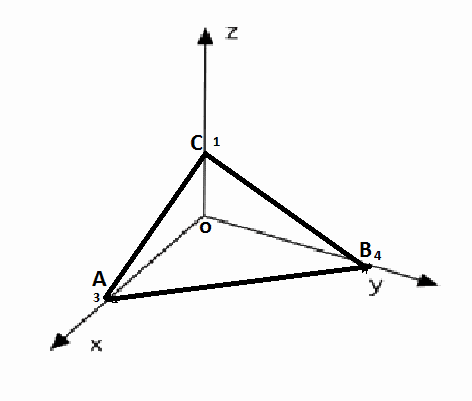

And here is picture:
3D coordinate sketch of a tetrahedron with vertices O at the origin, A on the x-axis labelled 3, B on the y-axis labelled 4, and C on the z-axis labelled 1, with the x, y and z axes drawn and labelled.
I know every line equation as well.
The task is to calculate this integral as:
1. surface integral of outside of the area (in the picture)
2. using Ostrogradsky formula
Equation of plane: 4x+3y+12z-12=0
It means that x=3-0.75y-3z and z=1-0.25y-(1/3)x
I guess, this can be integral for task 1, when we use surface integral:
Handwritten-style double integral expression: integral from 0 to 1 of integral from 0 to -4z+4 of ((12-3y-12z)/4) dy dz, plus integral from 0 to 1 of integral from 0 to (12-3y)/4 of ((12-4x-3y)/12) dx dy.
Can someone chek, if it's correct? And how to start task 2, when I have to use Ostrogradsky formula?

What are we going to do with this evol? I have some questions and observations:
(1) Isn't the (real) double contour integral above just a surface integral?
(2) If this is a surface integral, then the double integrals you're written are not correct. The integrals you wrote are just simple volume integrals. Also, the outer limits of the second integral are incorrect for a volume integral: the upper limit on y is 4 and not 1.
(3) Your statement above, "1. surface integral of outside of the area (in the picture)" is not clear at all. What area? Do you mean the surface integral over the triangular region intersecting the axis planes? Would be better to say something like, compute the surface integral:
[tex]\mathop\iint\limits_{\text{Red}} x dS[/tex]
Where "red" is the surface in the plot below. What would that surface integral be?

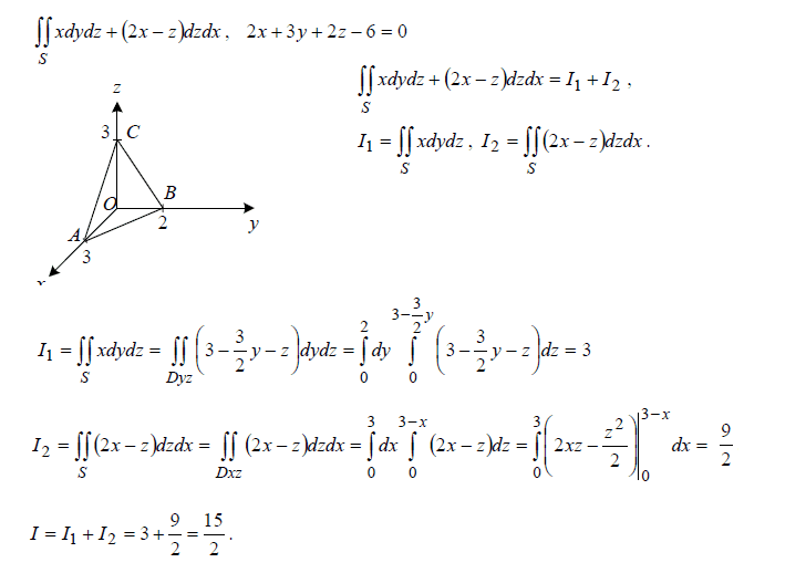

Hmm.. I tried to use this example:
Handwritten solution of a surface integral over a tetrahedron with vertices at the origin and on the z, y and x axes at 3, 2 and 3, with the plane 2x + 3y + 2z - 6 = 0 and the integrals I1 and I2 evaluated on the yz and xz projections.
Why in that case my solution is wrong?
Handwritten solution of a surface integral over a tetrahedron cut by the plane 2x+3y+2z-6=0, with a 3D sketch of the tetrahedron on the axes marked 2, 3 and 3, and the split into I1 and I2 evaluated to 15/2.
Hi evol,
I don't wish to steer you wrong. Perhaps I'm misunderstanding what you're trying to do here. Those integrals above are just volume integrals and not what I believe are surface integrals. Maybe though I'm not understanding this problem.
I guess, I don't understand this problem as well.
I will try to find out, what exactly I have to calculate.
