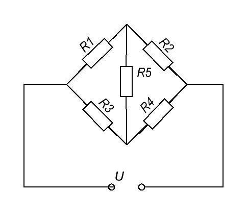

It's only one question. How to transform this ciruit to only one resistor?

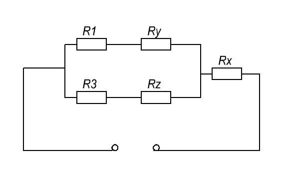

that all my ideas for now(where Rx Ry Rz are the results of "triangle->star" transformation)
  • Circuit schematic of resistors R1, Ry, R3 and Rz in a bridge-like network, with Rx in series on the right and two terminals at the bottom.
Yes, a Delta-Y transformation will get you there.
Another approach is to imagine a voltage source V across the terminals and solve the loop equations for the current in the voltage source loop. The ratio V/I is the equivalent resistance.

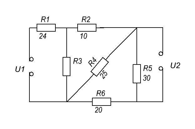

For this circuit(?) Delta-Y transformation does not help.(Find U1/U2)

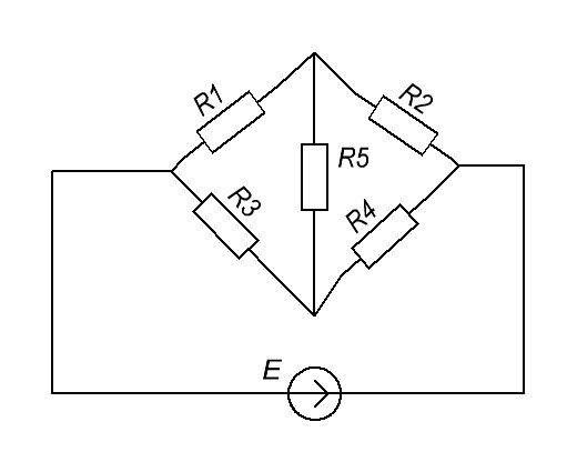

I still don't understand.Sth like this?
  • Circuit schematic of a bridge network: resistors R1, R2, R3, R4 form the four sides of a diamond and R5 links its top and bottom corners; the left and right corners connect to a voltage source E at the bottom.
Yes, exactly.
gneill said:
Yes, exactly.
But how can it help?What loop includes E?
E --> R3 --> R4 --> back to E
A!I see now.

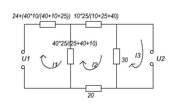

Can I do like that?
When I find I2-I3=I(on R=30 Ohms) will be I=U2/R(30)?
  • Circuit schematic with two terminals U1 and U2, three loop currents labelled I1, I2 and I3, and resistor expressions 24+(40*10/(40+10+25)), 10*25/(10+25+40), 40*25/(25+40+10), 30 and 20 printed on the branches.
builder_user said:
Can I do like that?

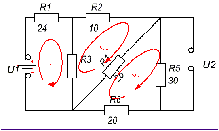

What happened to diagonal resistor R4? It should make two loops out of the "square" R3-R2-R5-R6.
You don't want U2 to be in a loop: it's a 'measurement' that you want to make, not a source voltage. It happens to be the voltage across R5.
The loops I had in mind are as depicted in the attached figure.
  • Circuit schematic with a battery U1 on the left, resistors R1 = 24, R2 = 10, R3, R4, R5 = 30 and R6 = 20, a diagonal dashed line dividing the network, voltage U2 at the right terminals, and three red loop currents i1, i2 and i3 drawn as circulating arrows.
gneill said:
What happened to diagonal resistor R4?.
Delta-y transformation
Ah. I see. So now you're down to a situation with just two loops to worry about.
When I find I1 && I2 then I can find I3.I3*R(30)=U2 right?
Since the terminals where U2 is measured are an open circuit, I3 must be zero.
The current through the 30 Ohm resistor (R5) will be determined by your I2.

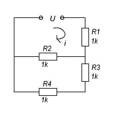

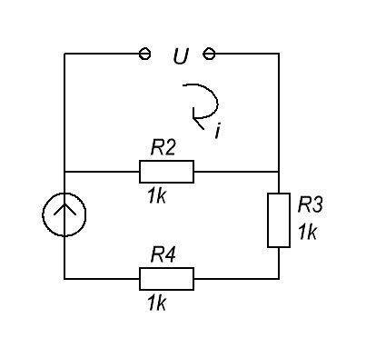

Does it mean that if I have such circuit(pic.) current i through R1 exists but when circuit does not have R1 there is no current i?
  • Circuit schematic with terminals U at the top left, resistors R1, R2, R3 and R4 each 1k, and a loop current i circulating through R1.
I'm not sure that I follow what you are saying. Is U in this circuit a real voltage source? Can you draw the circuit you have in mind that does not have R1?

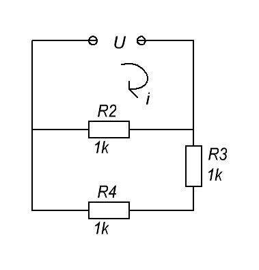

Here
  • Circuit schematic with terminals labelled U at the top and a loop current i; resistors R2 (1k), R3 (1k) and R4 (1k) are arranged between the two vertical sides of the outer loop.
builder_user said:
Here
Well, if U is a voltage source, then the current i exists with or without R1. It will of course have different values for the two cases.

In the previous circuit you're looking for a relationship between U1 and U2. That means, if you put a real source (say V1) where U1 is, you want to find what the open-terminal voltage is at the terminals U2. In such a case the terminals at U2 are open -- not connected to anything (except perhaps a voltmeter!). So no current will flow through U2.
Alternatively, you could put a real voltage source (say V2) where U2 is, and measure the resulting voltage at the U1 terminals. Again, in such a case the terminals at U1 would be open -- not connected to anything, and no current would flow there.

All I am saying is, if the terminals at U2 are open (not connected to a source), then there is no loop and no current flows (through terminals U2).
