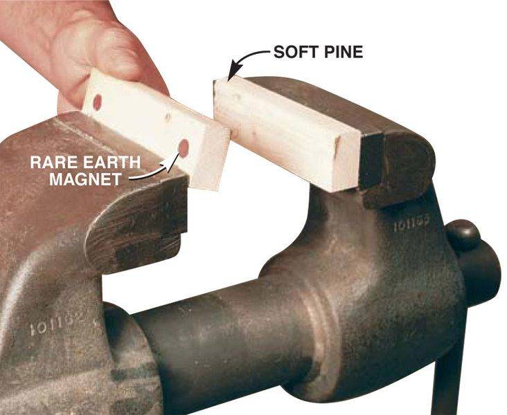

Thank you all. I'm still confused as to what I'm supposed to do with the wood?
Where you must grip or support an ugly shaped steel component, a block of wood will not damage the steel component.
The wood will conform to the component and so spread the load. The wooden block can be sacrificed to save the component.
Place the block of wood anywhere that will prevent the shaft from turning, such as in the gear teeth on the shaft.
How would I do that? Do I ahve to cut a piece of wood so it will rest on the table and also in the gear teeth?
You need more experience dismantling old machines like lawn mowers, bicycles and cars.
There is no hope. All is lost. You are in a situation from which you cannot recover, unless you take the first step.
If you are unable to take that first step, then you should take the motor to a friendly mechanic who is good at fixing things.
Steel vice jaws would damage the sprocket so use scrap wood as sacrificial soft jaws:
No need for the magnets, you'll be throwing them out after using them once, the sprocket will crush into the wood and you'll get a good grip.
