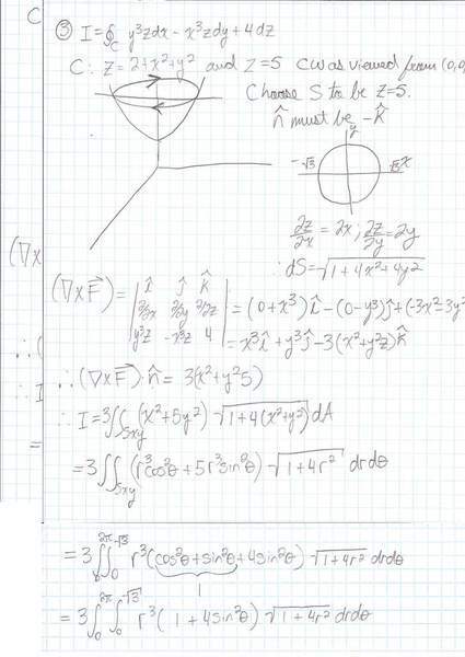

Use Stoke's theorem to evaluate the line integral
[tex]\oint y^{3}zdx - x^{3}zdy + 4dz[/tex]
where C is the curve of intersection of the paraboloid [tex]z = 2 + x^{2} + y^{2}[/tex] and the plane [tex]z=5[/tex], directed clockwise as viewed from the point (0,0,7).
Am I doing everything up to this integral correctly? I'm stuck at where I'm at now.
Did I make a mistake along the way?
EDIT: I found one mistake, since my surface S is Z=5, my dS should simply be (1)dA. I fixed my mistakes and found the answer to be [tex]\frac{135\pi}{2}[/tex]
  • Handwritten Stokes' theorem solution on graph paper: line integral setup, a sketch of a paraboloid cut by a plane, curl of F, and a polar double integral in r and theta.

Check your z component of curl F. You should be able to factor out a z. And with n=-k the integral should come out very easy.
