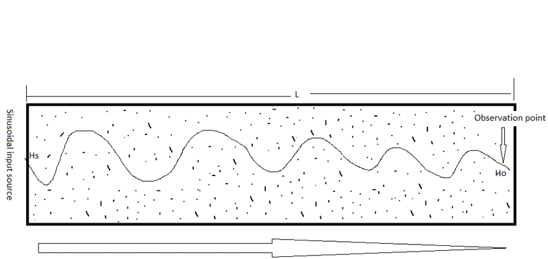

Consider the conceptual model presented in the attached image, of heat conduction in a bar.
There is a heat source at left side and heat is observed at point Ho after a distance L from the source. If we consider only heat transfer through conduction then this problem can be modeled by diffusion/heat conduction equation.
$$ \frac{\partial T}{\partial t} =D \frac{\partial T}{\partial x^2} $$
If I have developed a new semi-analytical or numerical solution (and eventually code) of this problem, then how can I validate my code?. For simplicity, suppose the source to be sinusoidal. Is there a standard solution for such an ideal case with sine input source, so that I can compare my code and then apply it to real field conditions?

Sure. See Conduction of Heat in Solids by Carslaw and Jaeger.

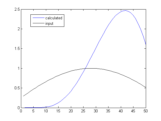

I have gone through some chapters of that book. He provides semi-analytical solutions in the form of equations for which we need to write code for example for example in case of semi infinite rod the solution he provides is
$$ \Delta h_m = \sum\limits_{m=1}^p \Delta H_m \{ erfc \frac{u}{2 \sqrt[]{p-m}} \} $$ p is total number of time steps and u is field variable.
I am unable to write a proper code for this equation. I have written following MATLAB code for this but it is giving me erratic results.
Code:
clear all; close all; clc;
deltat = 0.5;
deltaHvecc=sin(linspace(0.3,2.6,50));
deltaHvec=deltaHvecc-deltaHvecc(1);
x=45;
v = 40;
pvec = 1:50;  % total number of discrete values are 50
%suma=linspace(0,0,length(pvec));
u = x/sqrt(v*deltat);  % field variable
for i=1:length(pvec)
    p=pvec(i);
    deltaH=deltaHvec(i);
    suma = 0;
    for m=1:i
        erfcArg =  (u/(2*sqrt(p-m)));
      erfcfunc=erfc(erfcArg);  % calculating error function
      tek = deltaH*erfcfunc;
      suma = suma + tek;          % summation in the equation
    end
summa(i)=suma;
end
plot(summa); hold on; plot(deltaHvecc,'k')
The result of this code is given in the image I have attached with this answer, which is wrong as calculated can not be more than source.
So I can't compare the solution that I have derived with that of Carslaw and Jaeger.
My problem will be solved if either I am able to correct my code or get sample standard solution for the problem posed in original question.
  • Line plot with two curves over x-axis 0 to 50 and y-axis 0 to 2.5: a black curve labelled calculated rises from about 0.3 to a peak near 1 then falls to about 0.5, and a blue curve labelled input stays near 0 then rises to a peak near 2.5 before falling to about 1.6.
This is not the solution I had in mind. The solution I had in mind was for the dynamic steady state at long times, in which the temperature approaches $$T=T_0+A(x)\sin{\omega t}+B(x)\cos{\omega t}$$ This solution is given in Transport Phenomena by Bird, Stewart, and Lightfoot, Chapter 4, Example 4.1-3

The solution in Bird et al is: $$T=T_0+Ae^{-\sqrt{\omega/2D}x}\cos{(\omega t-\sqrt{\omega/2D}x)}$$where A is the amplitude of the temperature variation at x = 0.
