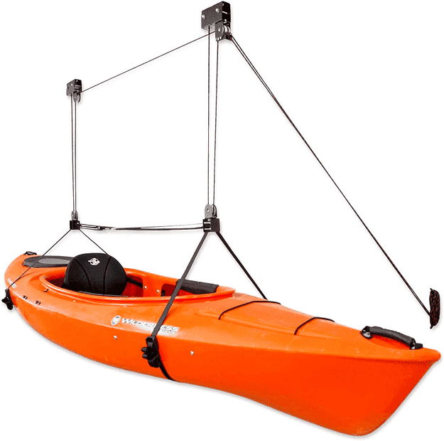

I wonder if it would be easier to use a rope harness and pulley to raise the boat- if it weighs less than you, you can stand on a scale while doing this and compare the two readings, the difference is the boat weight.
I can't visualize what you mean.
