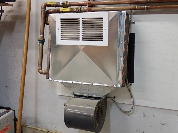

You first calculate the bending moment required. One of the first hits using search term mechanics of sheet metal forming is a book titled Mechanics of Sheet Metal Forming, by Marciniak, Duncan, and Hu. Chapter six tells you how to calculate the bending moment. From that, the force is calculated. Spend some time reading that book, and you will find out why it's so difficult to tell somebody how to do it in an internet forum. BTW, the material in this book is normally taught as a senior or graduate level course in mechanical engineering.
On the other hand, you can do like I did. I made a sheet metal brake from some angle iron, C-clamps, and hinges. It did a very nice job of bending the thin sheet metal for the fan coil unit (photo below), but bent the brake when I formed the 16 gauge mounting brackets.
