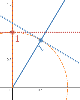

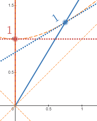

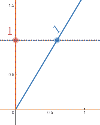

As a bridge from Euclidean geometry to Minkowskian geometry,
I think it's best to focus on what a circle is
(as something that defines a Euclidean metric, alternatively defining its dot-product)
and realize that the hyperbola is the Minkowski analogue of a circle.
It would further be helpful to realize where
the various constructions and operations you do in Euclidean geometry make use of a circle
and then consider the analogous construction in Minkowskian geometry.
One way to start is to play around with the E-slider in my visualization:
spacetime diagrammer for relativity https://www.desmos.com/calculator/kv8szi3ic8
where E=1 is Minkowski, E=0 is Galilean, and E=-1 is Euclidean...
In the spacetime cases, their "unit circles" represent the set of "first tick" events
for inertial clocks traveling with various velocities from the origin event.
Spacetime observers measure with a clock,
analogous to a Euclidean surveyor measuring with an odometer.

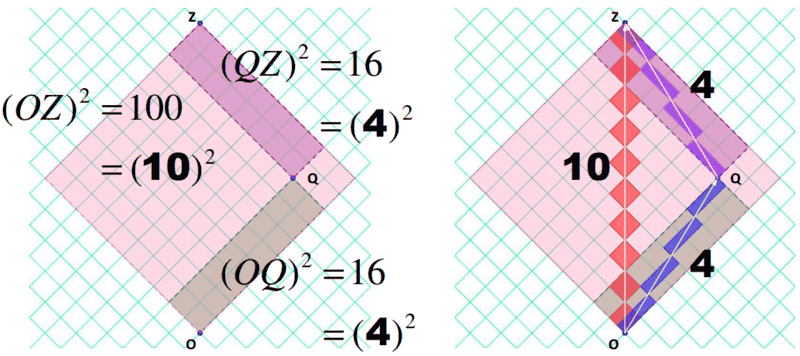

A way to visualize the square-interval is to draw the "causal diamond"
joining the endpoints of the spacetime-displacement vector.
For a timelike displacement, it's the intersection of the "future cone of the past event" with the "past cone of the future event".
Its area is equal to the square-interval [itex]\Delta t^2-\Delta(x/c)^2[/itex].
In the figure below, the area is 64.
So, the magnitude of the diagonal of the diamond equals 8.
Why? (It's based on light-cone coordinates from the eigenvectors of the boost in (1+1)-Minkowski.)
The lightlike sides have sizes
[itex]\Delta u=\Delta t+\Delta(x/c)[/itex]
[itex]\Delta v=\Delta t-\Delta(x/c)[/itex]
The area is [itex]\Delta u\Delta v=\Delta t^2-\Delta(x/c)^2.[/itex].
Since the boost has determinant 1, the signed-area is invariant under boosts.

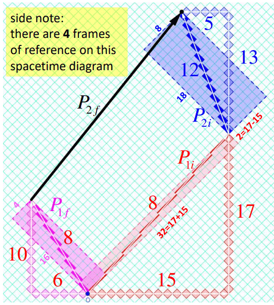

For something more recent that uses the causal diamonds,
see https://www.aapt.org/docdirectory/m...dGraphPaper-CalculatingWithCausalDiamonds.pdf
Here's a conservation of momentum problem from the above slides.
Find the magnitude of [itex]P_{2f}[/itex]. (Hint: draw its causal diamond.)
If you want the spatial-velocity of the timelike segment, you could use
[tex]v=\frac{\Delta x}{\Delta t} =<br /> \frac{<br /> \frac{1}{2}(\Delta u-\Delta v)<br /> }{<br /> \frac{1}{2}(\Delta u+\Delta v)<br /> }<br /> =<br /> \frac{<br /> \frac{\Delta u}{\Delta v} -1<br /> }{<br /> \frac{\Delta u}{\Delta v}+1<br /> },[/tex]
where the aspect ratio [itex]\frac{\Delta u}{\Delta v}[/itex] is equal to square of the Doppler k-factor.
In the first diamond with [itex]\Delta u=16[/itex] and [itex]\Delta v=4[/itex], so [itex]k^2= \frac{16}{4}=4[/itex] and thus [itex]k= 2[/itex] so that [itex]v=\frac{4-1}{4+1}=\frac{3}{5}[/itex].
