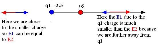

My slightly different equation worked perfectly with the -2.5 and +6.
I was thinking E1 + E2 = 0 and E1 was negative while E2 was positive, so it worked out.
But it wouldn't work in a situation where both charges are positive. In that case there should be a solution with x between 0 and 1, but my equation fails - both terms are positive and can't add up to zero.
These equations do not take care of the signs for the E1 and E2 terms properly, due to the fact that squaring the distance wipes out its sign.
Why did you have d -x ?
(d-x) works fine. The answer is -1.82, so (d-x) = (1 - (-1.82)) = 2.82, which is the correct distance. There is nothing wrong with the (d-x). The problem lies with it being squared - that wipes out the sign so q/(d-x)² can't indicate the direction of the E field at different values of x. The same applies to the q/x² term.

Another way to think of it. Say you have a positive charge at x = 1. At a location where x > 1, the E field is to the right and E = kq/(x-1)² handles the sign okay. But it doesn't work for x < 0 where the E field is to the left and should be negative. Is there any way to modify the formula to make it handle the sign of E? How about
E = kq/[(x-1)*|x-1|]
But how would you work with that in your quadratic equation?
Is it because we know that it must be to the left? Why can't it be the right

The answer of x = 0.39m is correct if q1 and q2 are like charges, i.e. if they have the same sign.
But what test charge (plus or minus?) are you using to get that formula?
E = kq/(x-1)² works for either charge when to the right of x = 1.
That is, a positive value of q results in a positive E, meaning it points to the right. A negative value of q gives a negative E. But it goes wrong when x < 1.
