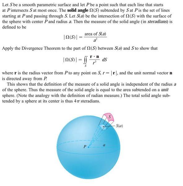

I can't accept the solution manual's explanation
4 replies · 2K views · last reply
kostoglotov
231
It's a long winded problem, I'll post a picture and an imgur link
Diagram of a blue sphere centred at P with radius a, showing a pink patch S on the surface and the corresponding region S(a) on the sphere, with rays from P to the boundary of S.
Imgur link: http://i.imgur.com/5wvbqO2.jpg
Divergence Theorem
[tex]\iint\limits_S \vec{F}\cdot d\vec{S} = \iiint\limits_E \nabla \cdot \vec{F} \ dV[/tex]
I'll follow my own solution up to the point that it disagrees with the solution given in the solutions manual, then I'll explain why I cannot understand/accept what the solution manual is telling me.

The solutions manual takes a slightly different, but equivalent route, but is telling me, at roughly this point, that [itex]|\vec{r}| = a[/itex].
I don't understand this. I can't accept it. [itex]\vec{r}[/itex] is the position vector from P to the surface S, not the position vector connecting P to S(a)...how can [itex]|\vec{r}| = a[/itex]?

I need to assume that the x,y,z that I use in my normal vector, are the same x,y,z that I use in [itex]\vec{r}[/itex] anyway...so that would mean that [itex]|\vec{r}| = a[/itex], but how can we justify this?
In the integral over S, the vector ##\vec{r}## goes from point P to a point on S, and in the integral over S(a), the vector ##\vec{r}## goes from the point P to a point on S(a). This is true simply because the integrals are being taken over those surfaces. The problem statement isn't saying that the symbol ##\vec{r}## always represents the vector from point P to a point on S in any context; it's saying this is the case for that specific integral. Note that you already used this fact when you evaluated the divergence of ##\vec{F}##. There, you took ##\vec{r}## to correspond to a point in the volume between S and S(a).
Ok, but, to quote the problem itself "r is the radius vector from P to any point on S"...there is absolutely a context within which to understand it that way.
I still don't get it. 'r' gives us our vector field. They really shouldn't write that r goes to any point on S if what they really mean is that r goes to any point on [itex]\partial S[/itex].
"Note that you already used this fact when you evaluated the divergence of ##\vec{F}##. "
Really?? I definitely thought the opposite right there. My reasoning went that for the surface S, x,y,z would be parametrized with phi and theta, BUT, that you could still just apply the vector differential operator to them first...
So, the vector field is just a position vector to any point in the region E...ok.
Yes, that's what the problem statement says, but what I'm saying is that it's saying that's what ##\vec{r}## represents in that particular integral, which happens to be evaluated over the surface S. When you calculated the volume integral, you evaluated the divergence of ##\vec{F}## at points inside the volume, so there ##\vec{r}## corresponded to the vector from P to a point in the volume, not on S or S(a).
