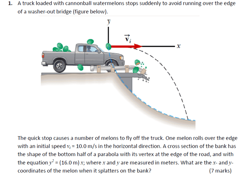

y2=(16)x is the equation on the question
I have got any clue. I do know how to solve motion in 2d. But since time is not given or the height is not given I don't know how to apply any of what i know to this question.
But my hypothesis is that since the hyperbola has an equation given i should use it to find minnimum of the curve. But that's all i got. Sorry but i found all attempts a dead end befor i begin because there is so less values to work with
  • Diagram of a pickup truck at the edge of a washed-out bridge with melons on its bed, one melon launched horizontally with velocity v_i along the x-axis, following a dashed parabolic trajectory down to a curved bank.
What condition must hold when the melon hits the bank?
If you were to find the path of the melon when it is launched horizontally with the given initial speed, could you calculate the x and y values of the trajectory, ignoring the shape of the bank?
The problem is not particularly well-worded. The vertex of the parabola must be the point where the melon takes off, as shown in the picture, not the edge of the road, as stated in the problem description. So the origin of the system is also as shown in the picture, and therefore the initial height is zero. (Of course, in general the actual location of the origin is arbitrary, but here it makes sense to locate it at the vertex of the parabola.)
You have, or can get, an equation for the trajectory of the melon, and an equation for the stream bed. What must be true, as SteamKing asked, when the melon meets the ground?

Well the question says the melon splatters on the bank
What can we say about the x and y coordinates of the melon and the x and y coordinates of the bank when the melon hits the bank?
It looks to me as if the problem is worded just fine. It's the art work that doesn't fit the problem too well.

No. The horizontal component of v is a constant: vx = 10 m/s .
The x coordinate of the melon, as a function of time is
x = vx∙t
x = 10∙t .​
also for vertical i tried s=ut+1/2at2
so s=0t+1/210t2
s=0+5t2
s=5t2
Note: use the X2 icon for super scripts.
You are almost correct regarding the vertical position of the melon. (Of course the melon's vertical coordinate goes down from zero, not up.)
So the y component of the melon is
y = -5∙t2​
Solve x = 10∙t for t and plug that into the equation for y, to find the path taken by the melon.
You now have two simultaneous equations in x and y to solve .

Distance in x axis
s=ut+1/2at2
s=? U=10 t=? a=0
∴ s=10t
Distance in y axis
s=ut+1/2at2
s=? U=0 t=? a=9.8
s=9.8/2 t2
t in x-axis and t in y-axis is same
substitute distance in x and y of y2= 16x
y2= 16x
(9.8/2 t2)2 = 16 x 10t
24.01t4=160t
make subject t
24.01t4/t= 160
24.01t3=160
t3=160/24.01
t3= 6.664
t=3√6.664
t=1.88s
substitute t= 1.88s in equations in x and y axis
s=10t
10x 1.88
=18.81
s=9.8/2 t2
9.8/2 (1.88)2
x= 18.81
y=17.35
is this correct?

That's for the x coordinate of the melon.
Therefore, x = 10t for the melon.
Distance in y axis
s=ut+1/2at2
s=? U=0 t=? a=9.8
s=9.8/2 t2
That's for the y coordinate of the melon, except that it should be -9.8/2 t2.
Therefore, y = -9.8/2 t2 for the melon.
Solve x = 10t for t.
Substitute that into y = -9.8/2 t2.
That will give y in terms of t, for the melon's trajectory.
Take this result together with the equation for the river bank.
This gives two equations in two unknowns. Solve for x any y. (There are two solutions.)
