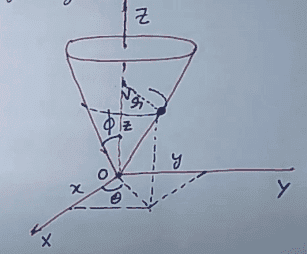

A person wrote that ##L=\frac{1}{2} m (\dot{r}^2+r^2 \dot{\phi}^2 +\dot{z}^2)## But, how to find equation of that coordinate system?

Call me dumb but I still don't understand what the OP is asking about, the Lagrangian (kinetic energy in this case) seems to be in cylindrical coordinates, but the picture he posted seems to show spherical coordinates.
Is it about to prove that the kinetic energy in cylindrical coordinates is equal to what the OP says?

That's not how interpret the picture. I see label ##z## which is appropriate to cylindrical and see no label ##r## which would be appropriate to spherical. This problem looks like a bead that is constrained to move inside a cone of half-angle ##\phi##. Furthermore, OP used cylindrical coordinates as generalized coordinates to write the Lagrangian.

That's exactly what he's doing.

It is obvious from the posted YouTube that the intention was to write down the Lagrangian, which consistits of two terms, but in order to show how to get the second term, the potential energy term, only the first term had to be written down first. That means that the phrase "a person wrote" in the original problem posted by
Istiakshovon refers to the first term in the Lagrangian only, the kinetic energy term only, since the complete Lagrangian had not been written down yet. So the way that I understand it, Istiakshovon wanted to know the equations of the coordinate transformation used to go from the usual scalar kinetic energy equation in rectangular coordinate system to one in cylindrical coordinate system. Based on the diagram of the cone that he gave, he wanted to know the transformation equations x = (r cursive)cosθ,
y = (r cursive)sinθ, and tan∅ = (r cursive)/z, or z = (r cursive)cot∅.

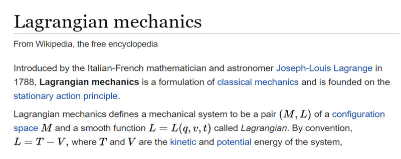

By definition, the Lagrangian L = T - U, where T = kinetic energy KE and U = mgz is the potential energy in a gravitational field. Transforming KE in rectangular coordinate system CS to cylindrical CS, the rectangular coordinate z in U must also be transformed using z = (r cursive)cot∅ which I mentioned in #21.
by the way ##T-U## is not the definition of the lagrangian, although this quantity will give the correct equations of motion for the mechanical system in many instances
@ergospherical
I'm sorry but I don't know about the lagrangian that you are talkimg about in #24. The Lagrangian that I'm talking about is the one shown below:
A Lagrangian is merely a differentiable function ##L : TM \longrightarrow \mathbb{R}## and a motion of ##L## is a function ##\boldsymbol{\gamma} : \mathbb{R} \longrightarrow M## which is an extremal of the functional ##S[\boldsymbol{\gamma}] = \displaystyle{\int_a^b} L(\dot{\boldsymbol{\gamma}}) dt##.
If the Lagrangian function is equal to the difference ##T-U##, where ##T = \dfrac{1}{2}mv^2## and ##U: M \longrightarrow \mathbb{R}## is some differentiable function, then the Lagrangian is called natural. This isn't a requirement and the Lagrangian sometimes does not take this form; ##L## is whatever it needs to be such that Lagrange's equations produce the correct equations of motion.
A simple example: the Lagrangian of a free relativistic particle is ##L = -m\sqrt{1-v^2}##.

The generalized cylindrical coordinates are ##r##, ##\theta## and ##z##. The equation ##z=r\cot\!\varphi## is a constraint that puts the particle on a cone of half-angle ##\varphi##. It is not part of the transformation equations from Cartesian to cylindrical.
@kuruman
I know that z = (cursive r)cot∅ is the equation of constraint but I did not mention it explicitly. Thanks for bringing it out. But now that you talk about it, I realize only now that I have the wrong idea in mind. The d∅/dt appearing in the kinetic energy (the Lagrangian without the potential energy term) given by the problem poster does not refer to the time derivative of the inclination angle ∅ of the cone, as shown in the original figure, but to the time derivative of the polar angle θ. I remember now that while it is customary in mathematics to give the cylindrical coordinates as (r, θ, z), in analogy to the 2D circular polar coordinates (r, θ), it is usually the case in physics that (ρ, ∅, z) is used for cylindrical coordinates; either ρ or cursive r for the radius of the cylinder and ∅ or φ for the polar angle θ in mathematics. The italic r in physics is somehow reserved for the radial distance of a point from the center of a sphere. With the variable z still in the equation then, it means that the kinetic energy expression given by the problem poster is already that one in purely cylindrical coordinate system and does not involve yet the inclination angle ∅ of the cone shown in the figure in his initial post. It appears that he doesn't know that the (∅ dot) in the kinetic energy actually refers to (θ dot) of the circular polar angle. So maybe, what he was asking for was the change in variable (transformation of variable = change in coordinate) needed to order to include the inclination angle of the cone in the equation, which is simply the change in variable z = (cursive r)cot∅ given by the equation of constraint.
