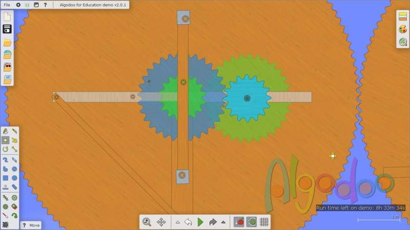

The dark blue 6in gear is locked to the axle. It runs at 20 rpms.
The light blue 3in gear connects to the dark blue gear. It runs at 40 rpms
The green 6in gear and the light blue 3in gear are locked together. Both run at 40 rpms
The green 6in gear connects to the green 3in gear. The 3in gear (free floating on the axle) runs at 80 rpms.
There is a brown rod mounted to the 3in green gear. It and its and its two weights will spin at 80 rpms.
The white rod, if held in place, starts the 80 rpm cycle. Let the white rod go and it will travel with the main wheel at 20 rpms.
My question is: How many ft lbs of force will be applied to my 3in green gear?
Think of it like this. A 40in wheel is running at 20rpms. The white rod stops causing the brown rod to suddenly spin at 80 rpms.

How does the white rod work?
Why?
That looke like it would give an enormous force on all components which change their rotation frequency, probably breaking something. The force depends on the ability of the material to stretch/compress/break.
If I've understood correctly...
With the white lever free to rotate the whole gearbox spins round so the weights go at 20rpm. Then if you slow/stop the white lever the weights spin up to 80 rpm.
Work out how fast you want the weights to spin up.
From that you can work out the torque you need to apply to the weights.
I think the torque on the white lever will be roughly twice (or is it four times that?) that.
PS Those weight going at 80rpm could apply quite a lot of shear force to a finger trapped in the mechanisim.

Let me try a better example. The 40in wheel turns 3/4 of a rotation along with the gears at 20 rpms. The white rod hits a stable object to begin the 80 rpm 1/2 rotation. During this time the 40in wheel travels 1/4 of a rotation. The white rod is released and the process starts again.
From what I understand from you and others is:
With the current configuration 20 ft lbs (4:1) applied to the white rod.
What I don`t know is it a continuous 20ft lbs or once the 80 rpms is acheived does it lesson.
Also, If I changed my 2lb weights to pendulums would it ease off the 4:1 ratio?
At that point I cry foul. No moving object that has mass can stop instantly. I'm sure you are familiar with F = m*a.
An instant stop implies infinite deceleration so the forces or torques would be infinite as well. There is always a "stopping distance" even if it's very short. Either your stable object or the white rod etc must deform however slightly.
Unless you know what that "stopping distance" is for the white rod you can't calculate the acceleration that the masses need to achieve. I refer to earlier posts asking you about the acceleration time.
why
A 40in wheel spins at 20rpm. Attached to its axle is a 6in gear also spins at 20 rpm. The gearbox is mounted to the white rod. If the white rod is held in place it causes the brown rod to spin a 80 rpm
To spin the white rod. Something I have mentioned before is on one end of the brown rod is a pendulum. 80 rpm will provide enough centrifugal force to raise a 2lb weight to the top.
As everyone can see this is not a pmm and could never work as a pmm. Unless you see the motor it will make you wonder. I have built test system and I`m almost ready to move forward with the full project.
You are correct and it is .25 second
It took me a very long time to figure that. Thank you for asking the question. It led me to the answer.
