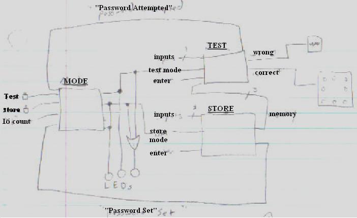

This is my first time trying to program a GAL22V10 w/ VHDL and I'm having troubles. I'm trying to make a password system with a storing mode and a testing mode, and LEDs to tell you which mode you're in. The user inputs are a reset switch, a test-mode switch, and store-mode switch, 3 switches to represent your password, and an enter button. There's also a time-out input which will take you out of your mode if you take too long to do anything (called "16 count"). The outputs are 3 LEDs, a "Wrong" pin, and a "Correct" pin.
I've attached a block diagram of how I want the processes to work. The code is also attached because it's hard to read on as posted
The problem is I think one GAL should be enough to execute this, as it has enough inputs, outputs and flip-flops, yet the only way I could get it to fit is to use a GAL for EACH process (total of 3). Why is this, and what can I do about it?

here's that block diagram

well the block diagram isn't appearing for me, maybe it is for you
Well I think I've come to the "Why" of my question, maybe someone could verify for me.
There's 10 outputs which can be either combinational or registered, but not both..So my design needed 9 flip-flops (2 of which would feed direct outputs), and 3 more combinational outputs, so I just had too many needs.
So am I just stuck with using more than one? It seems like most digital devices that do...a TON of stuff with very few of these...and I'm doing something that seems simple and small, yet I need 3 of them. What's up?
Well I've changed my design around a bit to save some room in the GAL. The LEDs get taken care of outside the GAL (frees up 3 outputs/flip-flops), the mode switches are now a single switch (frees up a whole process of determining which mode it should be in...2 flip flops), took out the signals "Password_set" and "Password_attempted" and put in an output that will go to an LED to show that the password is set.
That totals to 3 ouputs, 3 flip-flops, and 8 inputs used...i think that leaves enough room to maybe do something else if I wanted (bigger password?).
I'll let you know how it goes just incase anyone is curious
Yup, that fit on a single GAL...much better than using 3
