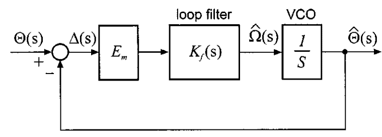

I'm trying to implement a basic PLL. The diagram is given as follows:
ufU8lrC
ufU8lrC
Where the transfer functions are given as follows:
o0BHksR
To implement the PLL I need it to be as follows:
gK0RkWm
How do I determine H(s) from the transfer functions that are given?
Thank you for your help

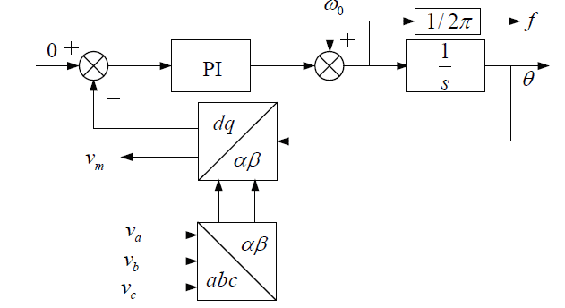

Based on your 3rd picture, the block diagram reminds me of the so-called synchronous frame-PLL shown below (see attached pdf for more details). Here the loop filter is basically a PI regulator.
Se also "Operation of a phase locked loop system under distorted utility conditions" by V. Kaura and V. Blasko if you are interested in PLL under distorted inputs.
