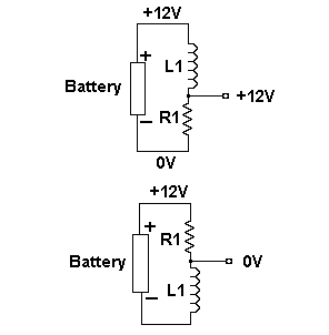

And what if a resistor or inductor (pure) came first.
a simple circuit ... +V line to inductor to resistor to 0V line
pick on an average inductor of a few turns or so resistance of the coil somewhere
between 0 and 1 ohm. If it was first in the cir4cuit then the voltage appearing on the side connected to the resistor would be practically the same as the supply voltage and ALL the voltage drop would be across the resistor.
if the resistor was first and inductor between the resistor and 0V. Because the resistance of the inductor is basically 0 Ohms, then that oV point is then also on the resistor/inductor connection point. So once again the the complete voltage drop is across the resistor

have a look at this pic and voltages of your 2 situations...
Thats assuming as in the comments in the previous post that the resistance of the inductor is near zero
as to not have a significant voltage drop for the sake of this discussion
