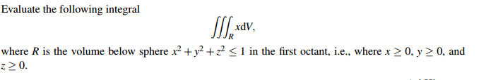

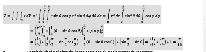

Schwarzschild90
111
And the volume element dV expressed in spherical coordinates.
Can you spot where I've made an error?
SammyS said:
What's you question?
Where is the error? * (Where have I made an error)
-Ok! Edited*
I don't see the error after going through what you did twice.
What is the correct answer?
There is a slightly easier way. By symmetry you can change the x to z in the integrand.
Ray Vickson said:
Why do you think you have made an error?
My study friends have gotten a different result than I. (Pi/8). And my intuition tells me that by integrating over radius=1, I should get something that looks like 1/8 the volume of a sphere of radius 1 (Pi/6). Would someone like to clear this up? I'd like to know if I'm doing something wrong.
Sure but the integrand, x, is on average less than 1/2.
You can check your answer by looking up the mass centre of a hemisphere.
I turned in the assigment. Giving it another shot tonight.
Do it the easy way: ##V = \int_0^1 x A(x) \, dx##, where ##A(x)## is the area of the slice at ##x## parallel to the ##yz## plane. The slice is a quarter circle of radius ##\sqrt{1-x^2}##, so ##A(x) = \frac{1}{4} \pi (1-x^2)##. This gives ##V = \pi/16##, as you obtained.
