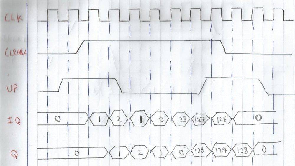

Complete timing signal from VHDL and identify what the circuit is used for (see picture below)

I have attempted to sketch the timing and got the following graph
From reading the VHDL code my understanding is io each rising edge clock tick the system will carry out one of the following (choosing based on priority):
  1. reset if Clear_L is high
  2. load in a value if Clear_D is high
  3. UP count if Up is high
  4. Down count if nothing else
From this, I got this graph:
243521
Points of interest are:
  • IQ rolls over to 128 when 0-1 happens (I believe that's how unsigned works in VHDL)
  • Q lags one behind IQ as with VHDL will simultaneous carry out all lexical blocks of code, meaning the check for UP will occur at the same time Q is assigned to IQ so it won't capture the changed value
But what the point of the circuit is, I am not sure. I guess it could be a for a reaction timer? But I'm really unsure. Especially as will rollover if left for too long and you can load a value in
EDIT: It would roll over to 256 not 128 in the graph as IQ is 8 bits, (I mistakenly read it as 7 bits)
