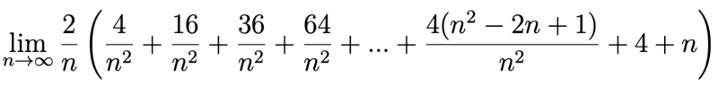

Consider the following limit of a Riemann sum for a function f on [a, b]. Identify f, a, and b,
and express the limit as a definite integral.
*see actual expression in the description below. it was too complicated to type out so I included a picture instead.
∆x = (b-a)/n
xiR = a + i∆x
xiL = a + (i-1)∆x
Hi! I understand that this is an expanded Riemann sum but I'm having trouble determining its original form. I don't actually have any ideas as to how to find it, but I know that once I determine the original form of the Riemann sum, I will be able to figure out the values for a, b, and f.
If anyone could suggest how to proceed I would really appreciate it. Thank you :)
The last term is 2. For the other sums you shall use the formula
[tex]1^2+2^2+3^2+...+n^2=\frac{n(n+1)(2n+1)}{6}[/tex]

Compare the sum to [tex] \Delta x \sum_{i=1}^{n} f(a + i\Delta x).[/tex] What would be a good guess for [itex]\Delta x[/itex]? One of the terms is given explicitly as [tex] \frac{4(n^2 - 2n + 1)}{n^2} =\frac{4(n-1)^2}{n^2}.[/tex] Can you guess the general form of the terms, and is your guess consistent with the first few terms given? How would you relate that general form to [itex]f(a + i\Delta x)[/itex]?

forgot to answer ! thank you for your help @pasmith and @anuttarasammyak :) I separated the terms and got f(x)= x^2 + 1
xiR = 2i/n -> x^2
n is just the riemann sum of 1 -> +1
∆x = 2/n
xiR = a + i∆x = a + 2i/n = 2i/n so a = 0 and b = 2
