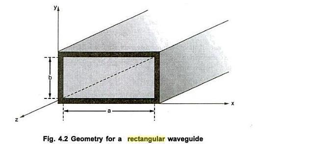

if b >> a ,Ex and Hy are zero .why ?
hello friends...in schaum series book on Electromagnetic field theory , its shown that if b>> a then Ex and Hy are zero , and only components present will be Ey , Hx, Hz...
can you please tell me the reson for that...what happened when we made b >> a...
( i know that if a > b the all five components mentioned above r present...)
i have uploaded image of rectangular waveguide...
  • Diagram of a rectangular waveguide with axes x, y and z; the cross-section has width labelled a along x and height labelled b along y, with a dashed diagonal, and the guide extends along z.

Do you really mean b >> a and not like in your picture a>b like for a usual rectangular waveguide? If you really mean b>>a, you might find the solutions with a parallel plate waveguide. Furthermore since I am curious, could you supply a amazon.com link to the book you use?
I believe that in the Fourier solution to the 2D wave equation with the rectangular waveguide boundary conditions, Ex and Hy are proportional to sin(1/b), and if b is very large then this would make the components go to zero. I'm not sure if that's what the problem is stating though.
Hmm, I thought in rectangular waveguide problems, depending on type of boundary conditions used, the relevant tangential components to sides are 0. That might be why. For example, if a perfect magnetic conductor(pmc) boundary was employed at the left wall of the waveguide above, then Hy component at that wall would be 0 due to pmc condition and so on. Similar situation with the pec condition.
