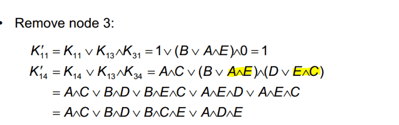

probability of AᴧBᴧBᴧC equal zero why!1
(B v AE)ᴧ( Ev C)
So after multiplication you should have
AᴧBᴧBᴧC
But he didnt mention this, so it should by zero ,but why!11

I upload the a picture for the problem ,when you look at the picture u will see, two yellow terms,which eventually will have to multiply them togethor,so all symbols will be in Intersection(4 symbols),
So my question why the answer is zero, since nothing come on the result from those terms

OK, I've read the attachment and it all makes sense, so long as the AND operation is defined as more binding than OR. So what is it you don't understand? What is it that appears to be zero?

In the expression X v (X & Y):
Suppose X is true. Then the whole expression is true.
Suppose X is false. Then both sides of the OR are false, so the expression is false.
Therefore the expression is equivalent to just X.
Likewise, X & (X v Y) reduces to X.
