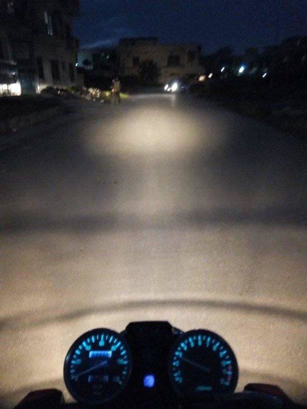

No LED is bad it only illuminates 3-4 feet then road cannot be seen I only have 40Watt less power issue If I install a second battery only 4AH 12v that is 48Watt then my generator can easily charge it also because when I give throttle even a little my beam become bright let me post pics so that you can understand
See the beam power this light is with 8.3A 12 battery but as beam needs 100W for low and 130 watt for high point I want its maximum output because bike also has tail light which has two bulbs they also draw some power and horn and speedo meter bulbs but for speedo meter I have replaced them with LEDS

core1985 said:
Okay thanks I shall first check but it generator can support the load then can I use capacitors or second battery?
capacitors won't do anything
They are used in cars with high power stereo systems to hold up the voltage during brief peaks in high power usage … not for a continuous load
Then you are not using the correct LED's
LED lighting on vehicles is becoming much more common
A LED light uses fewer watts per lumen. Watts are a unit of power, and lumens are a unit of light. So you can buy a LED light just as bright as you need, and it will use less power than an incandescent light with the same light output. As @davenn said, you are looking at the wrong LED.
