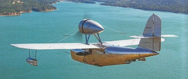

The 1936 Fleetwings Sea Bird was made from stainless steel. It's currently flying:
Photo scanned from page 49 of the February 2021 Sport Aviation magazine. Some more photos online - search N16793 to find them.
