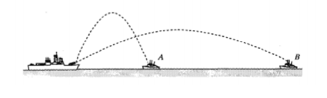

A ship fires simultaneously at two targets. If the projectiles follow the parabolic paths shown in the figure, which is hit first? Is there a way to solve it by using kinematic maths? I´m thinking if I solve the time for one projectile and then evaluate that exact time in the x(t) of the other could work, what you guys think? Is there enough information to solve?
x(t)=x0+v0xt
y(t)=y0+V0yt-1/2gt¨¨2

No need for any such assumption... and judging from the diagrams, not true.
This is probably supposed to be solved mathematically, but a moment's look at the diagram will show intuitively which one will hit first.
Hint: ignore the horizontal component completely. In fact, make it zero (easily done: pretend you are behind the target craft in line with the shots, and thus can see no horizontal component at all).
Look at the vertical component only. Which one must "land" first?

archaic said:
The vertical one,
Right. What in the diagram directly gives you information about how the two vertical speeds compare?
archaic said:
Well, I have ##v_{Ay}=v\sin(\varphi+\theta)## and ##v_{By}=u\sin(\varphi)##. But, although ##\sin(\varphi+\theta)\geq\sin(\varphi+\theta)##, we also have ##u\geq v##.
You don't need any algebra. From the diagram you should immediately be able to see how the vertical components of the launch velocities compare.

To echo @haruspex's post #10. Just look at the drawing. The projectile that spends less time in the air hits the target first. Focus on the vertical motion and think maximum height.

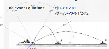

Yes - if you look at the horizontal axis - apart from anything else - it is very misleading! Following is a screen shot where I (approximately) measure the projectile angles. Based on these angles an interesting exercise is to determine expressions for the respective distances to target A and target B in terms of a presumed common projectile velocity v and accn of gravity g.
The drawing is misleading only if you assume that the muzzle velocity is the same for the two projectiles. That's because the initial angles appear to be close to equidistant from the 45o angle which means that the ranges must be more or less equal. If we accept that the drawing is to scale, we have to relax the requirement of equal muzzle velocities. @haruspex hinted at that in #3.
True enough - Haruspex had it right in all respects. For interest here's a Wolfram Alpha plot which more or less shows the situation in the diagram. Have chosen angles of 60 and 30, velocities 100 and 150 m/s and g = -10m/s^2. The angles look somewhat distorted because I can't get WA to do 1:1 axes scaling. As can be seen, the 60 degree projectile has some way to go at the time instant (15 s) when the 30 degree one hits its target.
