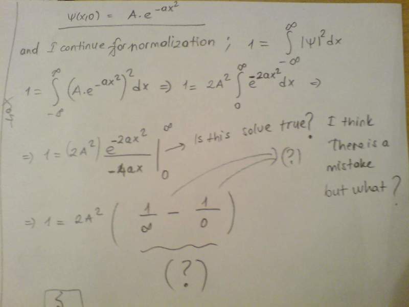

actually, there ıs a something I don't understand about the e value
I could not figure it out this integral while solving for quantum physics, you will see the equation in figure. The problem is how We can make a solution about the e number while solving in integral.. Such as e power any number.. you wıll see in figure as well. I just wonder only how to solve problem which contain e number. I knew before about that, W

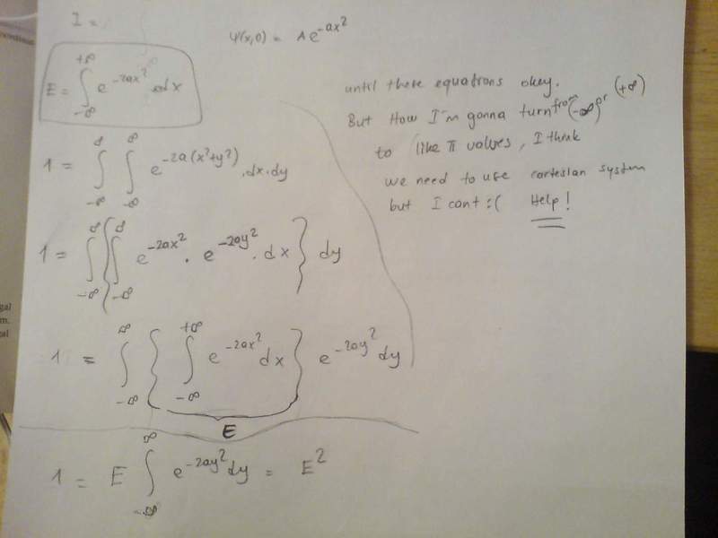

yes all of you are right that you showed me, the best way, I think It is going to be show you my solution..:)
Could you check a photo I added here?
I hope This will be clear. Please help

i'm sorry, opeth_35, this is completely wrong :redface:
∫ e-2ax2 dx is not e-2ax2/(-4ax) …
(differentiate the RHS, and you'll se you can't possibly get the LHS)
there is no elementary integral of e-2ax2 (though of course there is the "non-elementary" error function, erf(x), see http://en.wikipedia.org/wiki/Error_function" :wink:)
to integrate ∫0 e-2ax2 dx, you need to learn a standard trick:
multiply it by ∫0 e-2ay2 dy to get an ∫∫ dxdy, then convert to polar coordinates …
what do you get? :smile:

ok, now put e-2ax2e-2ay2
= e-2a(x2+y2)
= e-2ar2
finally convert "dxdy" to polar coordinates :smile:

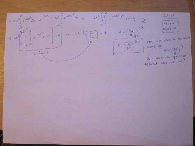

hey.. I stucked again in polar coordinates, any help?
hi opeth_35! :smile:
-∞-∞ dxdy
is over all of x and y,
so in polar coordinates, that's all of r and θ, ie the limits will be 0≤r≤∞, 0≤θ≤2π :wink:
how do u know, the boundries for teta between 0 and 2pi , haven't figure it out?
and why is going from 0 to -ınfınıte for r, It could be from -infinite to +infinite ?
no, in polar coordinates, r cannot be negative, it is defined as being 0≤r<∞ …
likewise, θ is defined as being 0≤θ<2π :smile:

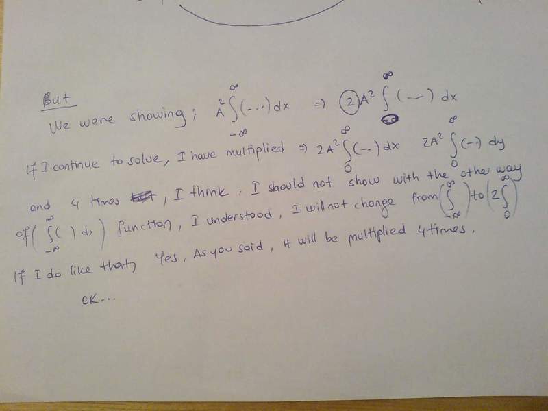

:) finally I found one value for solve , but the book shows different value, Could u check my calculate?
