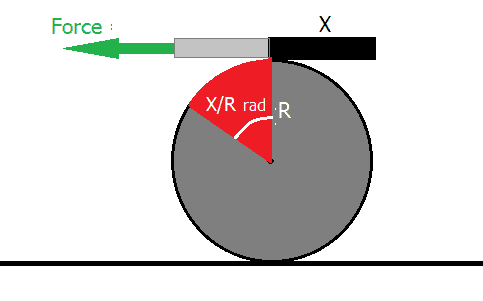

A sphere or radius R and mass M is pushed tangentially with constant force F for X meters as with a flat bar of length x moving across the top of the sphere. The sphere moves without slipping horizontally on a flat surface as shown below.
The force being constant produces a constant translational acceleration a = F/M and a constant rotational acceleration α. = L / I where L (torque) =F⋅R and I is the moment of inertia. The work required to do this has two parts one rotating it and one moving the center of mass horizontally. The force is applied for a distance of its length x causing the sphere to rotate θ radians where X=R⋅θ.
Thus the translational work is Wt= F⋅X and the rotational work is Wr = L⋅θ.
After the force has been applied the sphere moves with constant velocity V and rotates with an angular velocity ω. The two which are related by V = R⋅ω.
This results in the kinetic energy of translation KEt=½⋅M⋅V2 and rotation KEr=½⋅I⋅ω2,
Because of the constant acceleration, the translational and rotational velocities are related to their respective accelerations and the distance of the applied force by similar equations. V 2 = 2⋅ a ⋅x and ω 2= 2⋅ α ⋅θ. (Avoids the consideration of the time the force is applied.)
Using the above relationships, it is easily shown that the total work done is equal to the total resulting kinetic energies.

gleem said:
I think I'll leave it the way it is.
OK. I will try to follow your analysis and see where it goes wrong.
You appear to be assuming that although there is rolling without slipping that the frictional force of the sphere on the platform imparts no momentum, provides no torque and does no work. That is, that the frictional force turns out to be zero.
I disagree with this, but will accept it for the purposes of argument.
Let us go ahead and apply the force ##F##. The claim is that the resulting acceleration is ##a = F/M##.
We can go ahead and apply the torque as well. The claim is that the resulting angular acceleration ##\alpha = \frac{L}{I} = \frac{F \cdot R}{I}##. The moment of inertia of a sphere is ##\frac{2}{5}MR^2##. So we end up with ##\alpha = \frac{5F}{2MR}##. If we multiply by ##R## to convert this angular acceleration rate to a rate of horizontal acceleration, we get ##a = \frac{5}{2}F/M##.
The angular acceleration is 2.5 times too fast. We would not actually maintain rolling without slipping under these conditions.
Non-zero friction with the platform has to provide enough retarding torque and advancing horizontal force so that the rotational acceleration and the horizontal acceleration match.

  • #73
The OP did not specify a coefficient of friction so I think my assumption of not slipping is justified. If the frictional force is zero, there would be no rotation, so there must be friction. The frictional force is not moving so it does no work (neglecting rolling friction) and does not affect the final kinetic energy.
My post was to demonstrate that the work done was equal to the final kinetic energy. that is
$$KE_{tot}= \frac{1}{2}mv^2 +\frac{1}{2}I\omega ^2 = FX+ L\theta=maX+I\alpha \theta $$
$$v^{2}=2aX $$ and $$ \omega^{2} =2\alpha \theta$$
$$KE_{final}=maX+I\alpha \theta =mXv^{2}/2X +I\theta \omega ^{2}/2\theta $$
Now I did find this analysis surprisingly simple since when I considered using V2 = 2Xa, I could almost see where it was going to take me.

  • #80
jbriggs444 said:
If the center of mass is displaced by X then the cumulative distance moved by the rod that is supplying force F is 2X.
I just rolled a cylinder without slipping with a ruler on top as in the OP. The center of the cylinder moved the same distance as the ruler.
  • #81
What, exactly, did you measure?
If you measured the forward progress of the center of the cylinder and separately measured the forward progress of one end of the ruler then you should clearly witness a 2:1 ratio, ruler:cylinder.
If, however, you measured the forward progress of the center of the cylinder and separately measured the rearward progress of the point of contact where the cylinder rolls on the ruler, you should clearly witness a 1:1 ratio. (The cylinder rolls forward 1 unit, the ruler forward by 2 units and the delta covered by the point of contact relative to the ruler is -1 unit).
  • #82
It should be obvious that the top of a rolling cylinder moves twice as fast as it's center. So if you don't have any slippage (neither at the ground, nor at the ruler), then a horizontal ruler touching the top will also move twice as fast as the center.
From: https://www.miniphysics.com/uy1-rolling-motion.html

First, @jbriggs444
I see said the blind man as he picked up his hammer and saw that the speed at the top of the sphere is moving twice as fast as the center so the bar moves twice the distance compared to the center. Thanks for your patience.
Second: @A.T.
Actually, I always knew that but somehow did not see its relevancy until @jbriggs444 kept my attention on the actual work that was being performed.
A.T. said:
The dimensions in ths equation don't match.
As for this, I was requested to use LaTex for my equations and in a rush accidentally forgot to replace F with m. but thanks anyway.
I will edit my previous posts to show appropriate corrections and errors suitably struck out.

gleem said:
$$KE_{tot}= \frac{1}{2}mv^2 +\frac{1}{2}I\omega ^2 = FaX + L\alpha =FaX+I\alpha \theta $$
As I reconstruct the intent we have several typos and some idiosyncratic usage.
@gleem has been using ##ma## as a synonym for ##F##. One ##FaX## should read ##FX## and the other should read ##maX##.
@gleem has been using ##L## for torque. ##L\alpha## should have read ##L\theta##. I will use ##\tau## for torque instead.
With those corrections in mind we arrive at:$$KE_\text{tot} = \frac{1}{2}mv^2 + \frac{1}{2}I \omega^2 = FX + \tau \theta = maX + I \alpha \theta$$That equation is, at least, dimensionally consistent.
Although it is wrongly motivated, the resulting equation is even correct.
While ##F \ne ma## and ##\tau \ne I \alpha##, the sums of the two terms: ##FX + \tau \theta## and ##maX + I \alpha \theta## do indeed happen to match. The discrepancy in the one exactly cancels with the discrepancy in the other. Because the unaccounted for force does zero work.
  • #86
OK, but ##KE_\text{tot} = FX##, not ##FX + \tau \theta##.
  • #87
If ##X## is the distance that the center of mass moves then the mechanical work done is ##2FX##. And since ##\tau = FR## and ##\theta = \frac{X}{R}##, it turns out that ##\tau \theta = FX##.
  • #88
I went by diagram by @gleem where ##X## is the distance of the upper bar applying the force ##F##, so ##FX
## would be the total work done and thus the total change in ##KE##.
  • #89
OK, I agree with that.
I had not interpreted the drawing that way. But it makes perfect sense, now that you've drawn my attention to it. It does mean that evaluating the work done by the same force twice would be double dipping, just as you've said.
  • #90
Wait. I am currently working on revising my post per your suggestions and have changed my diagram to
It would have been posted by now but overnight I lost a lot of my work for some reason and will have to redo it.
