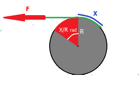

A sphere or radius R and mass M is pushed tangentially with constant force ##F## for ##X## meters as with a flat bar of length ##X## moving across the top of the sphere. The sphere moves without slipping due to a frictional force ##f## horizontally on a flat surface as shown below. The frictional force contributes to the net force on the sphere as well as the rotation.
The force being constant produces a constant translational acceleration ##a = F/M-f/M## and a constant rotational acceleration ##\alpha = L / I ## where## L =(F+f)⋅R## and ##I## is the moment of inertia. I will assume for this discussion that ##I=kmR^2##. The work required to do this has two parts one rotating it and one moving the center of mass horizontally. The force is applied for a distance of twice the length ##X## of the bar causing the sphere to move only a distance##X## and rotates the sphere θ radians where ## \theta =X/R##.
Using the above relationships we determine that $$a=2F/M(1+k)$$ and $$\alpha= 2kRF/I(1+k)$$
The translational work is## W_{T}=F⋅X## since f is not applied over a distance along the surface. The rotational work is ##W_{R} = (F+f)R \theta##. The total work ##W_{total} = 2FX##
After the force has been applied the sphere moves with constant velocity ##V## and rotates with an angular velocity ##\omega##. The two which are related by $$V = R\omega$$.
This results in the kinetic energy of translation ##KE_T=\frac{1}{2}⋅mV^{2}## and the kinetic energy of rotation ##KE_R=\frac{1}{2}⋅I\omega^{2}##.
Because of the constant acceleration, the translational and rotational velocities are related to their respective distances of the applied force by similar equations.
$$V ^{2} = 2⋅ a ⋅x $$

Using the above relationships we find
$$V^2= 4FX/(M(1+k))$$
and
$$\omega^2=4kFX/(I(1+k))$$
The total kinetic energy is
$$KE_{final}= \frac{1}{2}⋅I\omega^{2}+\frac{1}{2}⋅mV^{2}$$
So $$KE_{final}= \frac{1}{2}⋅I\omega^2=4kFX(I(1+k))+ \frac{1}{2}⋅M4FX/(M(1+k)$$ thus
$$KE_{final}= 2kFX/(1+k)+ 2FX/(1+k)$$ which is ##2F## the work done by ##F##

What makes you think that ##\theta = \frac{X}{R}##?
When you give up friction, you give up on rolling without slipping. Now the rotation angle is de-coupled from the translation distance.
I'd called this potential error out in the last paragraph in #93 above.

Perhaps, reanalyzing the situation where the sphere slips so the frictional force is divided into two parts one doing work as it slips resulting in the applied force providing the only torque, and one that does no work while working with the applied force to rotate the sphere. then take the limit as the friction goes to zero. Maybe?
I admit that the scenario of a bar being able to exert a torque without imparting some motion perpendicular to the direction of the force may not be physically realizable.
I'm thinking that the situation with no friction may be as shown below in which case θ=X/R sort of a Yo-Yo situation. Think of the sphere sitting on a frictionless surface with its axis of rotation perpendicular to the surface.
Sure. A spherical child's toy top being pulled from a string wound around its circumference and viewed from above.
But now there is nothing on the diagram to indicate how far the center of mass translates.

consider the following diagram
[snip incorrect diagram]
gleem said:
The impulse applied to the end of the massless extension transfers its motion to the end of the rod, but the massless extension contributes nothing to the change in momentum.
The only mass moving is the pencil, and it is moving much slower than the end of the extension.
The pencil is laying on its side and is viewed end on. The extension is perpendicular to the pencil. It is attached to the long side of the pencil and extends vertically upward, away from the frictionless surface on which the horizontal pencil rests.
The massless extension moves rigidly with the pencil. You are correct that any impulse applied to the extension has the effect of applying that much momentum change to the pencil.
You are correct that the only mass moving is the pencil and that its center of mass is moving much slower than the end of the extension.
However, you have still not realized that the rotation rate of the pencil would be extreme. Nor have you showed any effort at performing the requisite calculation.

It makes the torque for the given tangential force, and thus the angular acceleration very large, which makes the time of force application over the given distance, and thus the transfered linear momentum very small.
Who cares what the shape of the object near the axis of rotation is.
Why do You think the rod is rotating at an extreme rate?

Because it was subject to an extreme torque. Or, to be technically correct, was subject to a large transfer of angular momentum.
You understand the idea of "impulse", right?
"Force" is the rate of transfer of momentum to the target object. But in many situations, we do not care about the rate. Instead, we just care about how much momentum was transferred. A large force over a brief interval transfers as much momentum as a smaller force over a longer interval.
In the scenario that I proposed, there is a linear "impulse" of 0.01 kg m/sec2 applied. Perhaps this was 10 N applied over an interval of one millisecond. Perhaps it was 10000 N applied over an interval of one microsecond. Perhaps it was .01 N applied over an interval of one second.
How much angular momentum was transferred into the system by this linear impulse?
I claim that the answer is ##\vec{p} \times \vec{R}## where ##p## is the impulse (0.01 kg m/sec2 and ##R## is the moment arm (1 light year or approximately 1016 meters). That comes to approximately 1014 kg m2/sec.
You might object to that calculation. Few physics textbooks bother to write this formula down for you. So let me justify it.
Suppose that the impulse was delivered as 1 N over a duration of 0.01 seconds...
Then the torque was 1016 kg m2/sec2. Multiply that by the duration of 0.01 seconds and we have 1014 kg m2/sec of angular momentum transferred.
Suppose instead that the impulse was delivered as 0.01 N over a duration of 1 second...
Then the torque was 1014 kg m2/sec2. Multiply that by the duration of 1 second and we have 1014 kg m2/sec of angular momentum transferred.
What sort of rotation rate do you expect when you have this much angular momentum on a pencil?

But impulse is about change in momentum and velocity. Clearly, the magnified torque at the rod is of no consequence. The tangential velocity of the rod is the velocity at the end of the extension times the radius of the rod divided by the distance of the tip of the extension to the center of the rod The angle of rotation is the same for the extension and the rod and so the angular rotation rate of the rod and extension are the same.
Nope. Torque is the rate of transfer of angular momentum. It has consequences.

Seems you missed my post where I explained the consequences to you:
A.T. said:
It makes the torque for the given tangential force very large, and thus the angular acceleration very large, which makes the time of force application over the given distance very small, and thus the transferred linear momentum very small.
You have to keep the boundary conditions in mind: the applied force and the distance over which it is applied are fixed. Changing the lever arm leads to the above, given those constraints.
No. That is not the boundary condition to keep fixed when comparing the cases with and without extension. The distance over which the force is applied is to be fixed.
I'd fixed the applied linear impulse instead. Which amounts to pretty much the same thing, give or take a square root and a factor of two.
