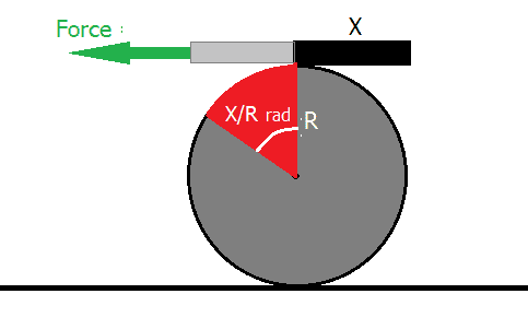

Interesting. Yes, the force is specified as tangential but there is no specification that it is applied at a fixed point on the sphere. The picture I had in mind was a tangential force that does not change direction, e.g. a thin jet of air at a glancing angle or putting the sphere on an accelerating conveyor belt.
I deleted the post you quoted to avoid confusion. A drawing would have been a good thing to have.
Yes, it's something like that, a force applied to the top horizontal tangent of the sphere.
Even if you're doing it that way, the linear distance through which the force is acting won't be 5 meters (which was the underlying point I was trying to make when I said the force would change direction--I was thinking of a different method of applying the force, putting it at a single point on the sphere with no slippage). As @Dale pointed out, the center of mass motion is less than the motion of the tangent point at which the force acts. So the final linear velocity will be smaller than what you are calculating. It should be obvious that the final linear velocity can't be what you would get from 5 joules of linear kinetic energy, since some of the work done is not going into linear motion.

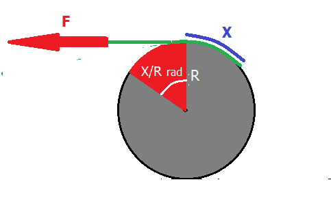

I cannot make sense of your numbers. The 17.5 Joules is meaningless to me.
For the linear motion
$$L=\frac{1}{2}\frac{F}{M}t^2\implies t^2=\frac{2ML}{F}$$
The translational kinetic energy is
$$K_{trans.}=\frac{1}{2}Mv^2=\frac{1}{2}Ma^2t^2.$$The rotational kinetic energy is $$K_{rot.}=\frac{1}{2}I\omega^2=\frac{1}{2}I\alpha^2 t^2.$$
Put in the appropriate expressions for the accelerations and the moment of inertia. Simplify the expressions and add them.

  • #37
Then see my answer above. That is exactly what I assumed.
Since you are getting confused with the displacements it will be better to calculate power rather than work. Use ##P=\vec F \cdot \vec v## and integrate over time.

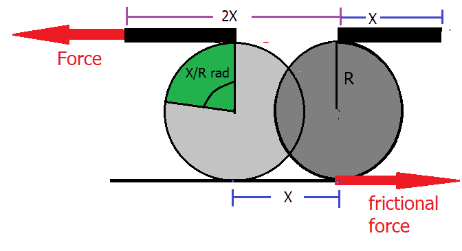

But I was thinking of the force as parallel with the ground but at the top of the ball, I wasn't thinking of a rotating force vector.
OK, that makes sense. Then the force is applied over a larger distance since [the material at] its point of application is both rotating and translating.

I don't think it answers my objection. If the force of 5 Newton were applied to the center of the sphere, the sphere would move 1 m without rotating, and the work done would be 5 joules. But in your case, the force makes the sphere move and rotate. So, the work should be more then 5 joules.
If I have a sphere and I apply a force to the top part to rotate it forward the top part of the sphere moves with velocity ##v_{top} = v_c + (R){\omega}## where ##\omega## is the angular velocity in radians per second about the center of mass and R is the distance between the center of mass and the top of the sphere where the force is applied, and ##v_c## is the velocity of the center of mass.
So if the top part is moving with a velocity ##v_{top}## the center of mass will be moving with a velocity of ##v_{top} - (R){\omega}## so the top part of the tire will move more than the center of mass meaning more work will be applied than I initially thought.
